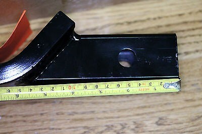

I think you have to get one with a shorter shank. I found the one Toyota makes but wont be able to verify its fitment until it gets here. it is 2" from the hole to the end, while most ball mounts were 2.5" long.

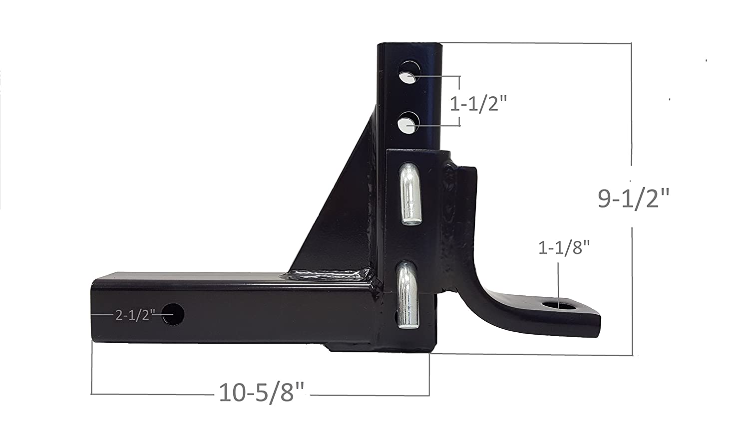

I'd like to be able to use an adjustable mount and may buy one and trim the end if it interferes with the spare tire.
https://smile.amazon.com/gp/product/B008CE06ZA/?tag=ihco-20
I have several receivers that fit, and several that don't. I've used a grinder on the edges of one or two to allow them to slide into the hole. I've had one cut off so that it didn't push into the spare tire. My current trailer-towing set up requires that the spare be positioned just right, or I use a really big C-clamp to push the receiver kind of into the spare to get the hitch-pin in. When I get around to it, I'm going to have 1/2" cut off of it to allow it to fit without issue.
[QUOTE="I'm going to have 1/2" cut off of it to allow it to fit without issue.[/QUOTE]
I've had to this this on several accessories like my bike rack, tow bar etc.
