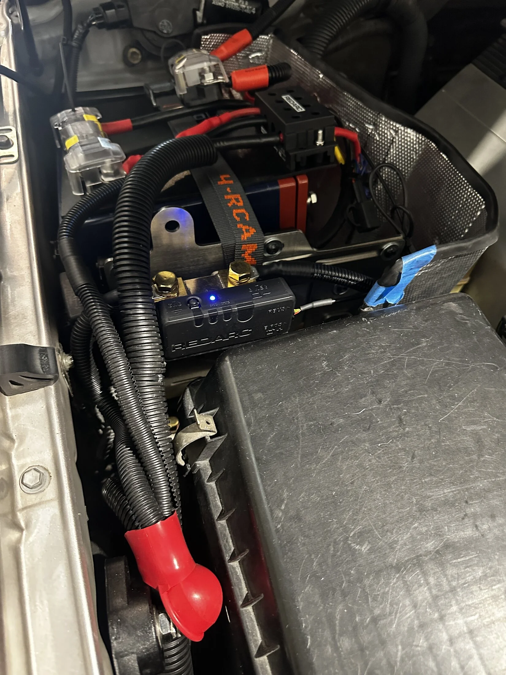

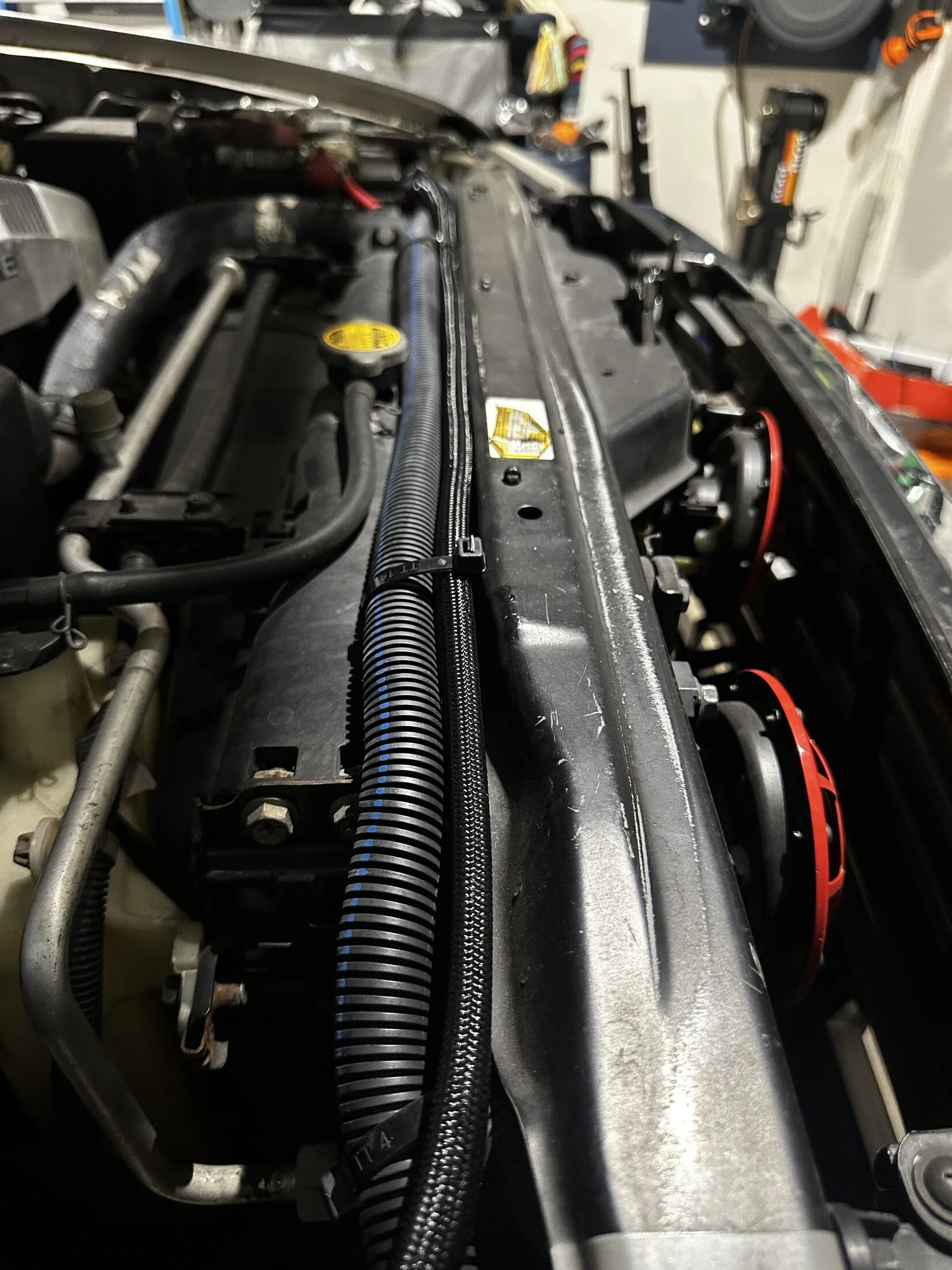

Thank you both for the advice. The photos are VERY helpful. I'm able to think through this more with this guided information. Sometimes you just need a little nudge to make sure you're not going in the wrong direction with so many information sources available.
