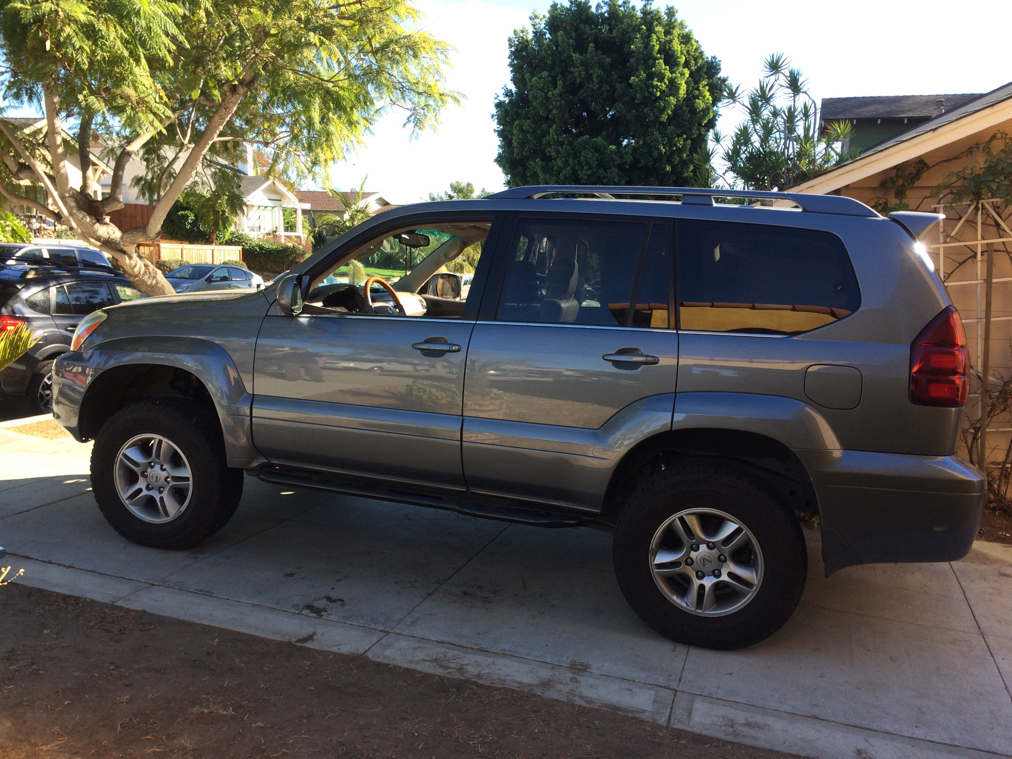

Here is how she looked right after the lift with the fronts set 1/2" too high. The shop that did my alignment lowered them down almost a 1/2" to get it more level but couldn't go all the way because the coilovers would be out of spec per ICON if they did.

Mine are cranked back down as low as they can go per spec according to the shop that did my alignment, I will have to get an updated picture. Unfortunately I do not have before measurements, totally forgot until I put it up on jacks and had the wheels off with PB blaster soaking the bolts the night before. So I was not going to put it back down just for measurements. :p
