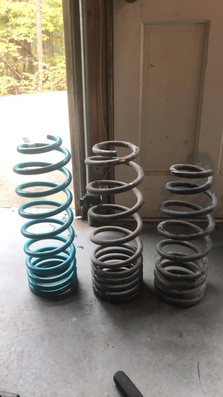

Good. You need them for those springs and anything heavier. Your icon 3" expos on the right. MT medium LT center and the dobinsons super heavy I run for now on the left.
I'm going to wager the springs will not be the issue - unless the spring rate of the Radflo's is considerably stiffer than the Icon's you bought. I seem to recall Eibach makes the springs for both of them, and there's likely little variation? Interesting experiment nonetheless, and following along...
