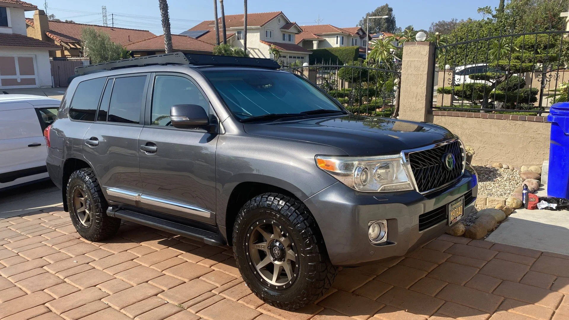

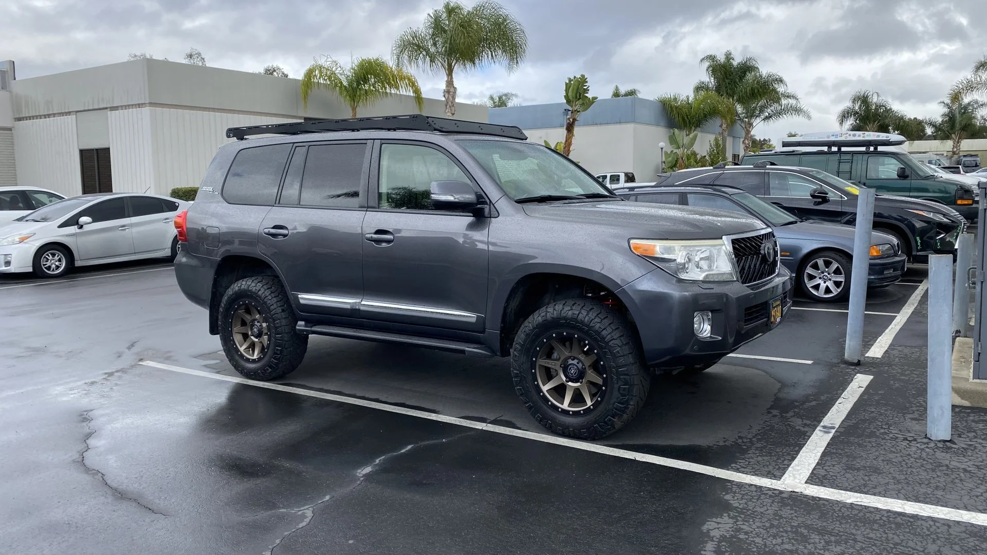

Love my Icon rebounds (18x9 +25), the bronze it subtle and no spacers needed to sit flush. Pre lift and post lift pics
