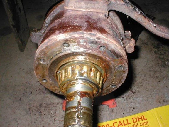

Don't know if anyone else has run across this. The original inner wheel bearing is a press fit on the spindle. When you go to pull the hub it's a little stiff because your pulling out the wheel seal. You have to use a bearing puller (or split it like I did) to get it off.

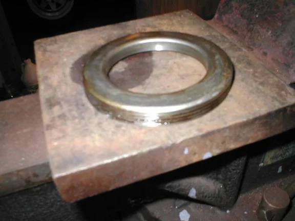

Here's the oddity though. It's an all metal wheel seal. It stays stationary on the spindle and the sealing surface is the outside edge with the three oil grooves. Opposite the way a rubber seal works.
All the early wheel bearings and seals work to replace these. But when you reinstall the hub nut presses the inner wheel bearing back on the spindle.

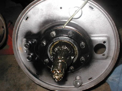

Also note in the first photo, the spindle is round on it's outer circumference. 40's are slabbed off on the front, back and bottom. John Pardi
This one is flat on the bottom............just hidden in the vise.

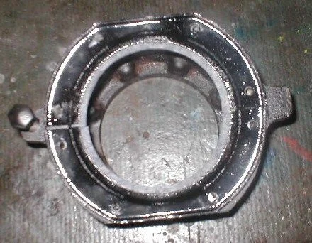

This is the knuckle seal from the 25. There is only a felt that tucks into the metal retainer, no rubber wiper. Not sure if its the same for real early 40's.
Anyhow, I use the later knuckle seal kit and trim the felt to fit. You can add the rubber wiper under the retainer if you trim it to fit also.

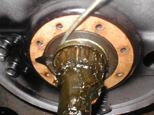

Anyhow, apparently the wheel seal can be installed to deep in the hub (remember that cute all metal seal?), I noticed that on the reassembly the hub had a rubbery feel when turning. The seal was definately being pinched between the bearing and seat. Sooooooooo, after a bunch of cussing :censor: I pulled the hub back off. And there it was........ the inner wheel bearing and wheel seal (which was now free) but behind the pressed on bearing.
Soooo, the decision had to be made, cut off the brand new bearing (still haven't found a puller that will work on this)....:eek:
Or figure out a way to reseat the seal. :idea:

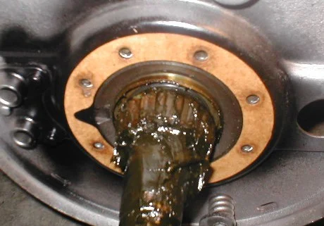

I took out the spindle bolts and put this handy piece of 3/16" cable behind the seal with a long whip sticking out:
Reinstall the dust seal and bolts, then press the hub back on (a few taps with a wood block will do) the wire rope acts like a backer and seats the seal to the right depth. Now yank on the whip and pull out the wire rope. Tighten down the bolts and you're right back where you started. :D
