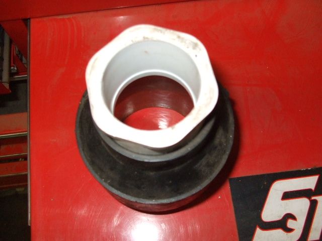

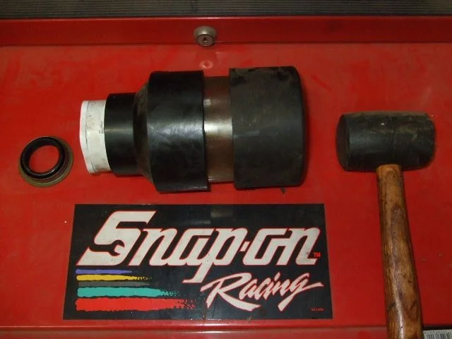

Simple ABS reducer coupler with another reducer and a cap.

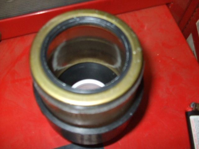

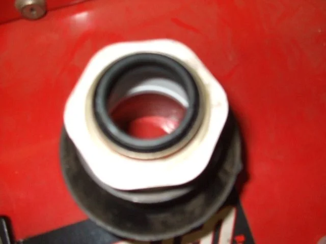

The small white reducer fits the axle seal perfectly. You cannot drive it to deep.
The OD of the pipe pevents you from driving the big seal to deep. If you think you might drive it to deep, put the cap on.
That's a creative idea! :cheers:

When used to drive the Big seal. Use a hammer big enough that it will not go in the small reduce. Make sure you do not smash the lip or raised area on the flatish side of the seal.
Very nice. One tool for both seals (assuming the larger end is for wheel bearing seal ). :clap:
