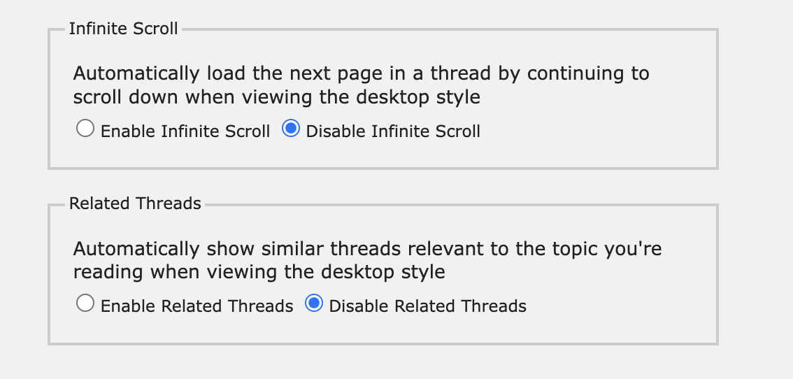

also, holy s*** do i hate the clublexus format. so hard to follow those threads for some reason
You definitely need to turn these off along with an adblock
