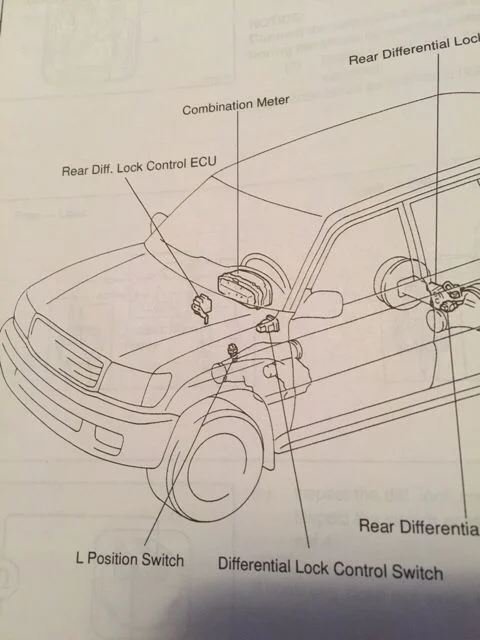

Has anyone actually seen one of these in the wild? Searching around behind the glove box, even behind the engine ecu there's no sign of it. The FSM shows it floating in the middle of the dash (which makes it a little hard to locate). Should I take the center of the dash out? Can anybody help locate it?

I found this diagram on a different site, not sure what year fsm it's from.

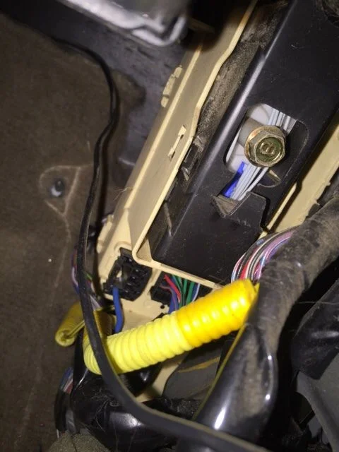

Seems to show it in the passenger kick panel. I'll try to take a look today. When I was searching above the kick panel I did find the" tranny relay" which this diagram says is the diff lock relay. Another poster also mentioned they are one and the same. Can anyone confirm that?

I think I'm hot on the trail.

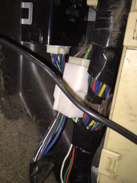

The trail has run cold. I can't see anything either in the kick panel or behind then glove box that looks similar except for the "transmission relay". I take it no-one on this board actually followed the FSM troubleshooting steps if their rear actuator didn't work? I am reluctant to start unplugging and dissecting these computers until I know I need to.

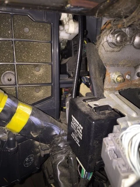

This is the closest thing I could find per the diagram (upper left hand corner black box). It's behind this giant yellow monstrosity:
In the kick panel. Now the black box actually says ABS. So I'm reluctant to mess with it, but maybe they're just talking about the material it's made of?? Can anyone confirm or refute this being the object at the end of my frustration?
Ah, you still didn't find it? Do you have the FSM? The pic in the second post, the black relay, is the CDL relay, IIRC. I'll check the part # next time I'm in the garage.

Thank you 40Habits. That gives me the confidence to dig it out. I guess the ABS printed on it really is the material it's made of.

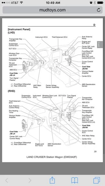

Look at this parts list. Afaik, the number you list in the 4th post is the CDL relay, while the Rear (& front, for the 105) is the one marked with a color here: (very cryptic part names)

...and the ewd looks like this: (look at the conductors marked *2. Disregard the *1 ones, and the front/rear-ECU)

The pdf that uHu posted above is a match for my 1999 USA LC with factory e-locker. (the *2 note is critical to making sense of it)
A huge help indeed as I couldn't find this schematic anywhere!
