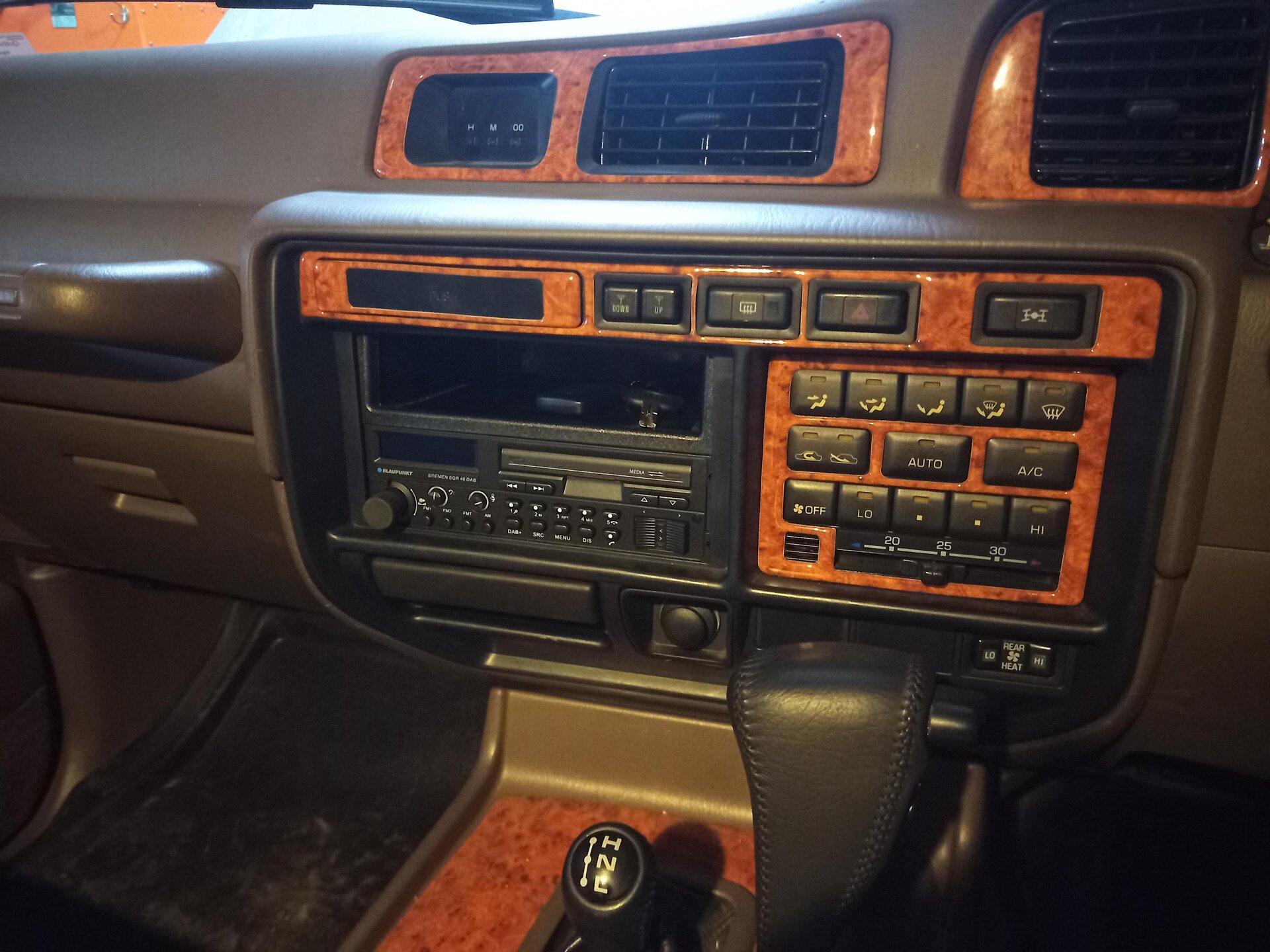

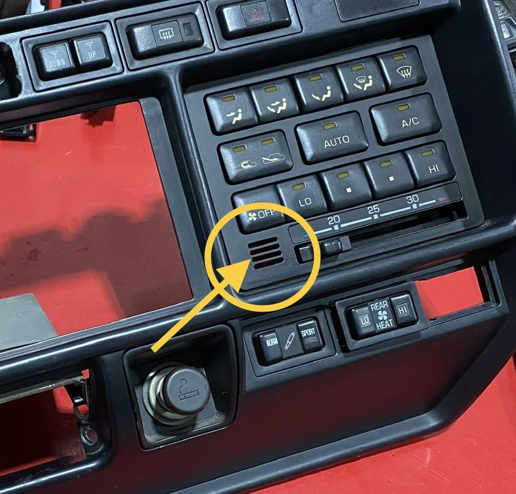

And another potentially stupid question - what's this A - M switch on the back of the HVAC controls? I couldn't find anything on it online. I assume Auto - Manual?

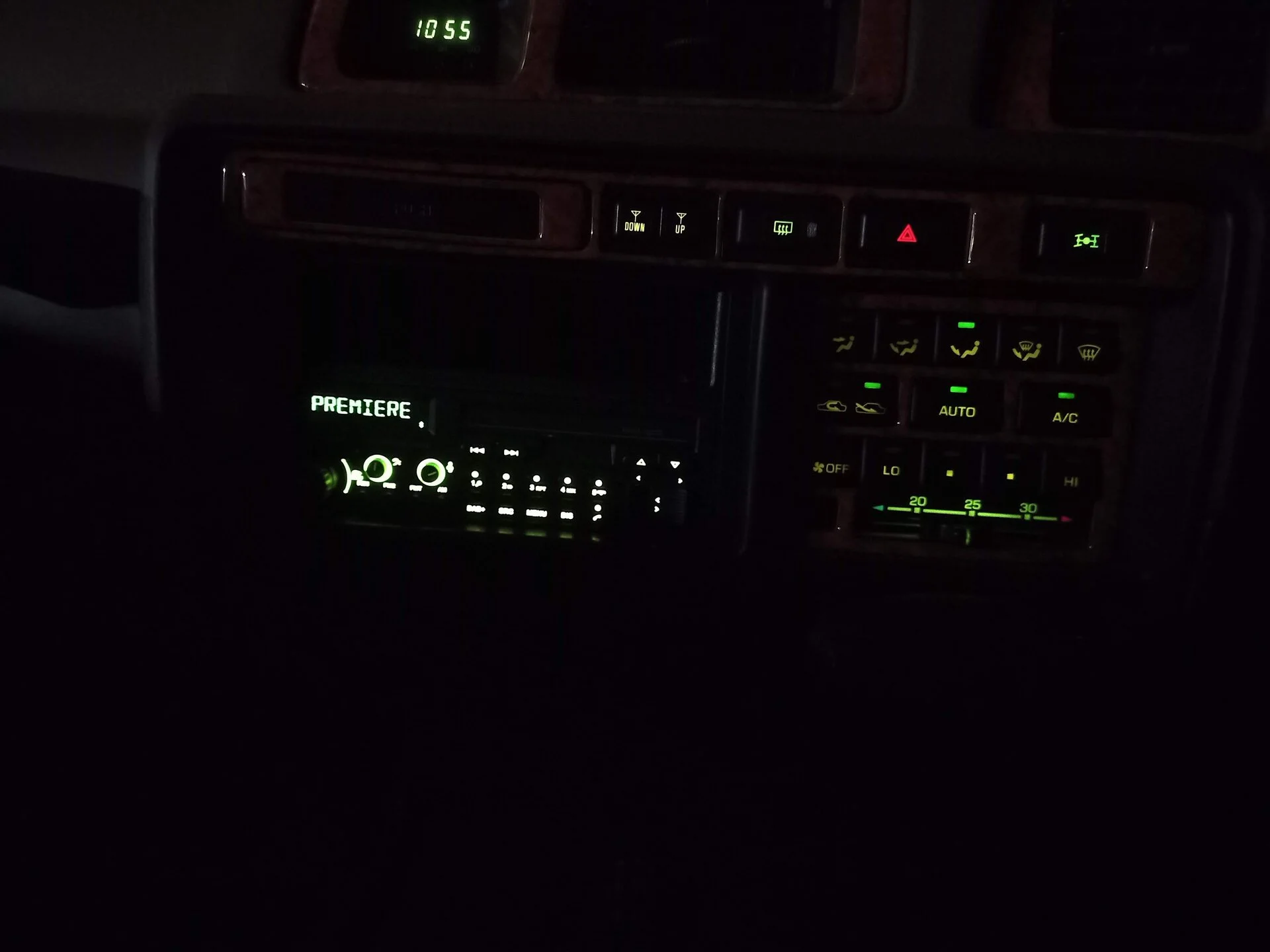

My head tells me Pioneer CarPlay:
But my heart tells me Blaupunkt:

Yeah I think that will let you disable the auto capabilities. I like them though!
Agreed. I'll leave it as is. I actually need to clean up the interior thermometer, it's got some gunk. I wonder if that affects the performance of the auto controls.
Pretty sure that corrugated white tube needs to connect to the back of this thermometer.

Your heart is telling you right !
Nice, how do you like it?
I chose the frankfurt because it is a RHD and the prev/next button is on the right. Overall its great ! Mated it with a storage compartment Amazon product ASIN B000281WCUi was able to build something nice. A little bit of trimming is required on the radio factory trim. Bluetooth works great, phone also works great. However, a diesel hdj81 is noisy and shaky and it is not great at highway speeds for the mic.

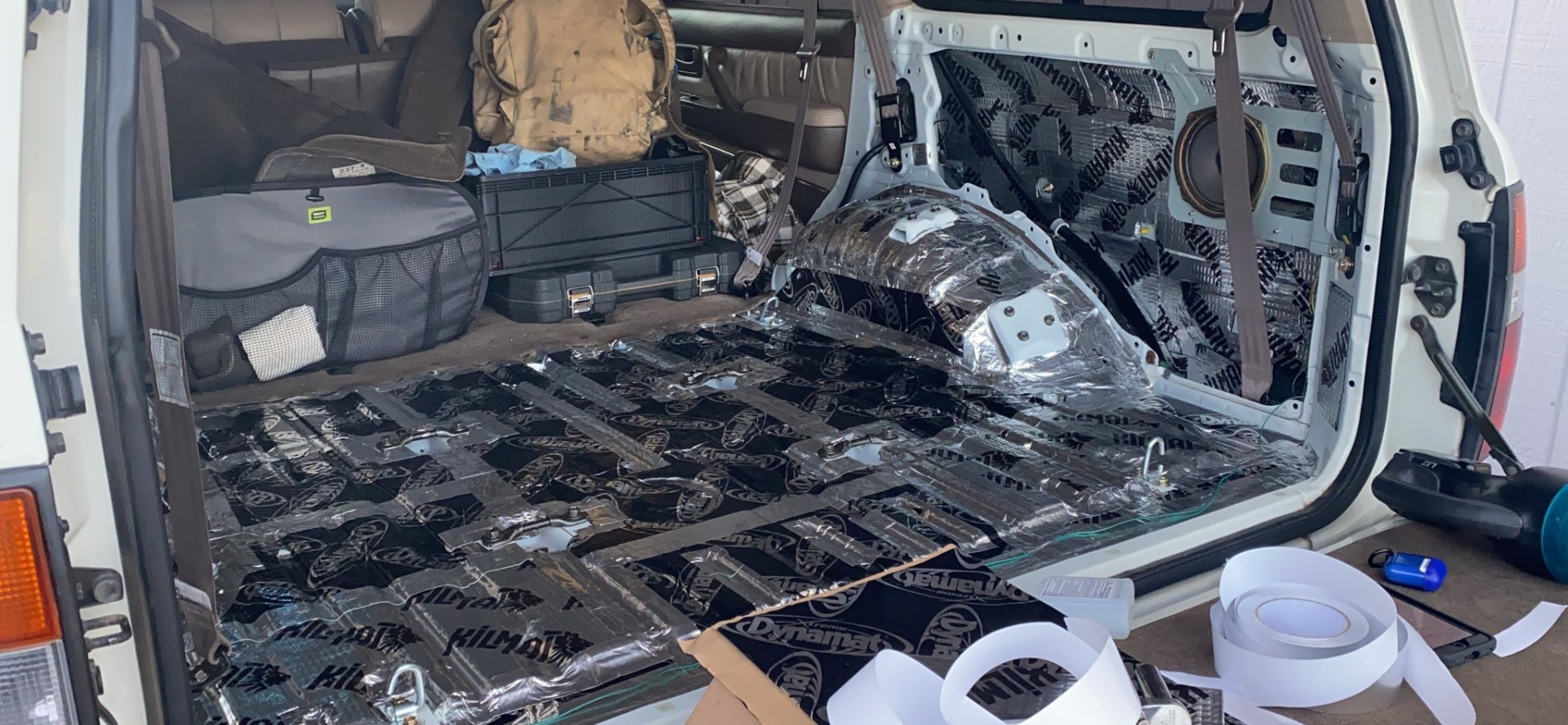

So, while I am waiting for my new bottom cushions in the mail, I got a wild hair and started sound deadening the rear cargo area.
Tips for anyone doing this...
  • Oddly enough I didn't read this anywhere... you NEED to tape if you are going to be installing carpet (so, anywhere horizontal really). When the interior gets hot the butyl rubber will squeeze out the sides and will stick to your carpet and make a mess.
  • Go buy the aluminum foil tape from hardware store of your choice, it's cheaper, literally the same stuff, and you will need a lot of it.
  • Work the matt into the ridges well or peel back the paper as you stick it down, if you lay it too tight when you press it in it will tear and will require taping
  • save your odd shaped cutoffs and add them in the gaps that are big enough... you'll cover it with tape later
  • Dynamat is nice for the wheel well areas in the front, but so far I think the killmat is a lot easier to install and way cheaper than dynamat. The texture makes it easier to cut straight free hand and the smaller pieces out of the box are a lot easier to work with (although it does mean taping more...)
