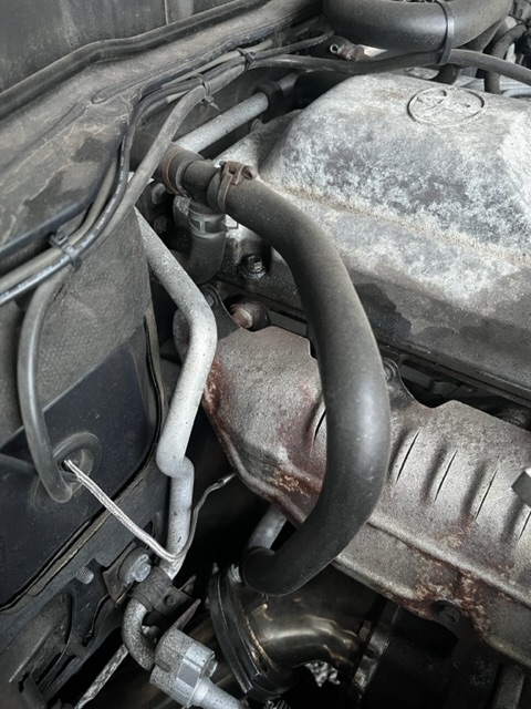

Got a blank for the EGR Exhaust outlet and had my buddy tig up the EGT port. Also got a new gasket:
The distance from the plate to the wall of the exhaust manifold is about 42mm so we'll meet halfway with the probe
Makes for a pretty clean install though I know the ideal spot would have been right in the middle of the manifold. Anyone have any hard data on EGT temps for just cylinder 6 vs an average of all cylinders?

@ikarus so is my egt plate under the heat shield? I operated under the assumption that my truck was a non egr Jdm…
Looks like you don't have EGR? Yeah you won't have that port on your exhaust manifold. It's this pipe that connects the exhaust to the EGR valves -

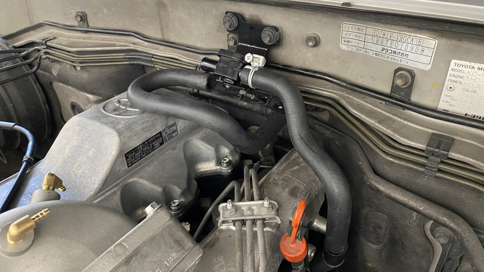

Spent a lot of time today reading up on the EGR system, BACS and SICS.
According to what I've read:
BACS is the Boost Altitude Compensation System. It uses vacuum (or the lack therof) to alter the movement of the boost compensator to decrease fueling when over 4K feet in elevation.
SICS is the Startup Ignition Control System. It similarly uses vacuum to deliver less fuel when starting up, for less smoky starts.
So I've decided to remove everything including the BACS and SICS VSVs. I live at 6K feet and mostly travel/wheel around 4K-10K feet. So I'll just run constant vacuum on BACS, simulating lower elevation, giving it more fuel, and tune accordingly. For SICS, I'll also plug in constant vacuum so it gets full fuel all the time.
In theory this should work. We'll see when I finally start it up in a couple weeks. @Rock40 had success with this setup in his epic 1HDFT conversion that I read through today:
And on the Australian FB groups, those guys have removed everything. I love how simple the setup is.
The last VSVs:
New vacuum line:
old vs new
Recreated some of the stock setup - this is the vacuum pump segment:
Salvaged some T's from the old crossover setup. I'm going to have the line from the vacuum pump run up here, then T into two hardlines that cross the intake manifold:
SICS is the canister closest to the engine. BACS is the vacuum port in the middle hidden by the fuel line. Top is the boost comp cap.
BACS and SICS plugged into the two vacuum hardlines with new hoses:
I'll most likely run the boost comp cap up to the third hard line, then around the intake elbow to one of the brass fittings.
Not much I can do with all the extra wiring short of dismantling the entire harness. I'll just have to zip tie it out of the way or something -
But overall I love how much cleaner and more simple this is getting.
