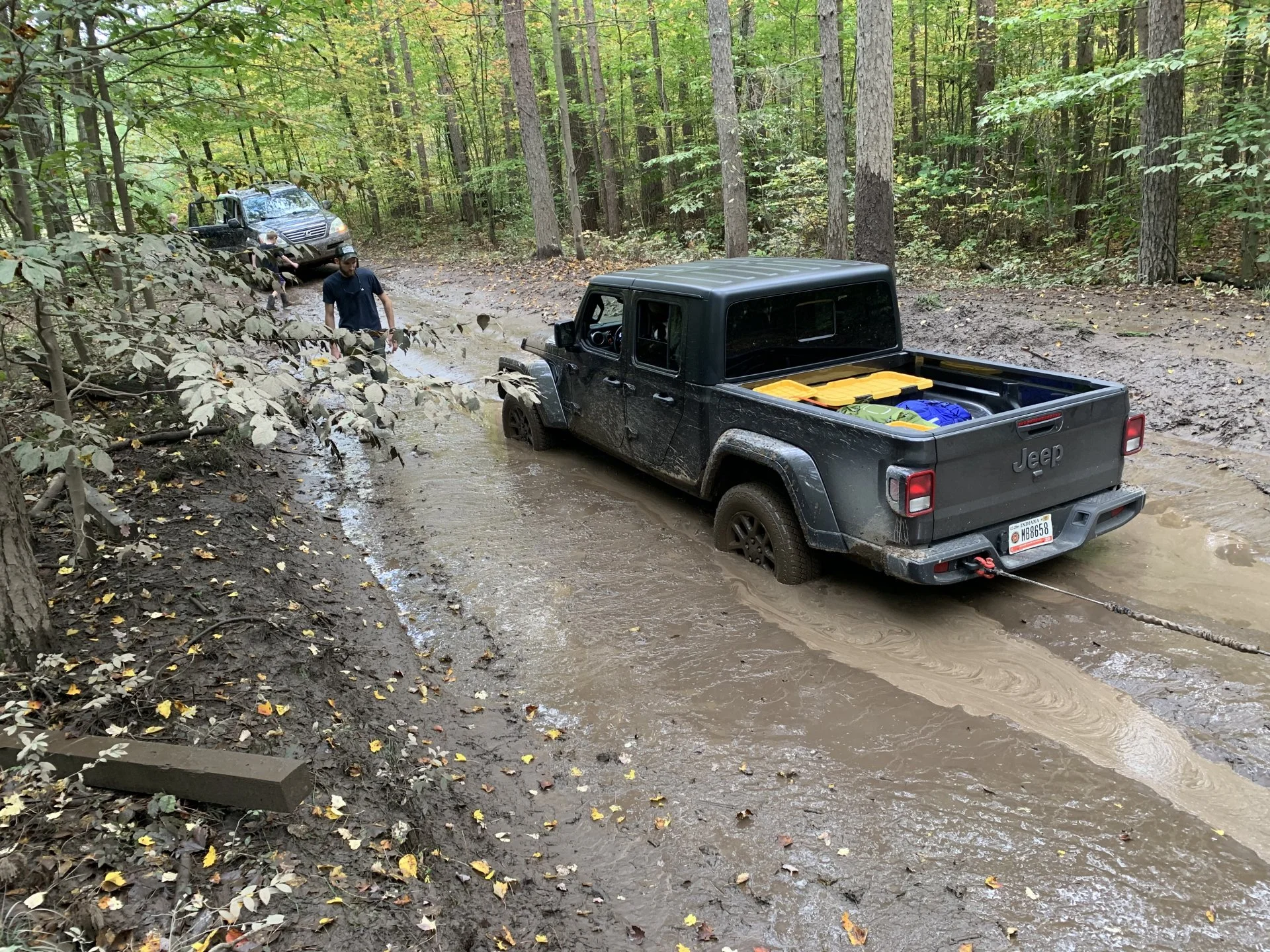

Spent the day off-roading on some trails with friends. Lots of deep mud which was fun.

In 4hi, the trails were mostly flat just had some big mud pits we played in, other than that we kept speeds around 10-20mph with some idling while chatting or watching people get pulled out (stuck gladiator for reference)

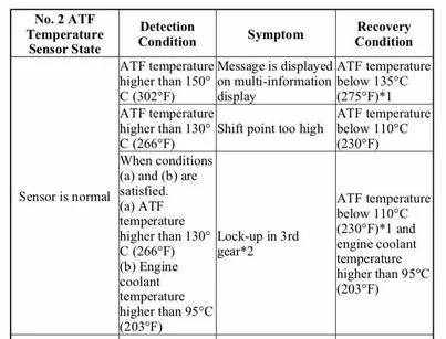

It should be around 170-180 just running around town and down the highway and actually stays at that temp off-roading (at least for me). I start to get nervous when it crests 200. Based on what I've read online 220 is entering the danger zone when the fluid might be getting cooked (we got up to 217 or so pulling a pass in CO in 3rd gear with the torque converter unlocked). I don't think it's ever been above 180-190 here in MO, even when I've had it nearly stuck in mud and snow. I'm currently installing a larger Hayden 678 cooler as we plan to get a pop-up camper next spring and I don't want to cook the trans on hills. In my experience sustained climbs really seem to cook it - our up and down hills here in MO that aren't that tall just don't get it that hot.
