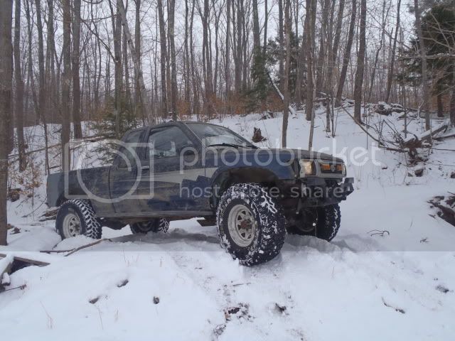

35x14.5's. 4 inch lift.
OH ya. That's what I am talking about. I can't believe those are 14" wide. I should not have too much trouble with a 12.5" then.
