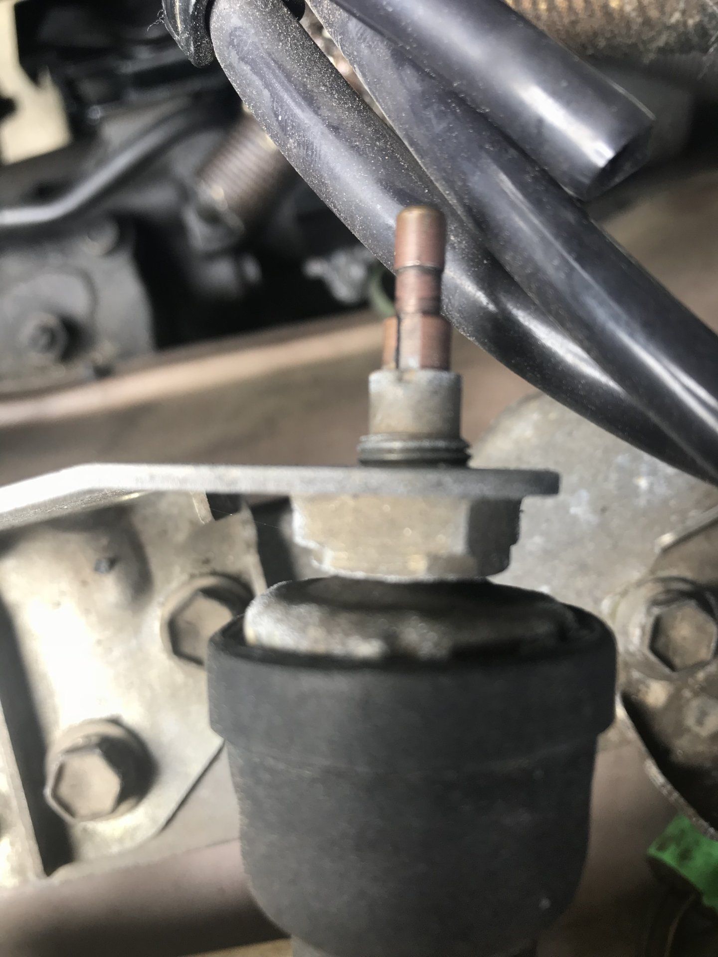

I’m trying to get my hands on a Ohm meter but in the meantime I look closer and it looks like I’m missing the o ring. Am I seeing this right? I couldn’t find a picture online of a vacuum switch with the o rig but it sure doesn’t seem present here.
Toyota says these are NLA. Any guidance on where to get an aftermarket o ring? Thanks!
That picture is the vacuum switch and that brass nipple needs to connect to a vacuum source. No O-ring needed. A wire should be plugged into the switch.

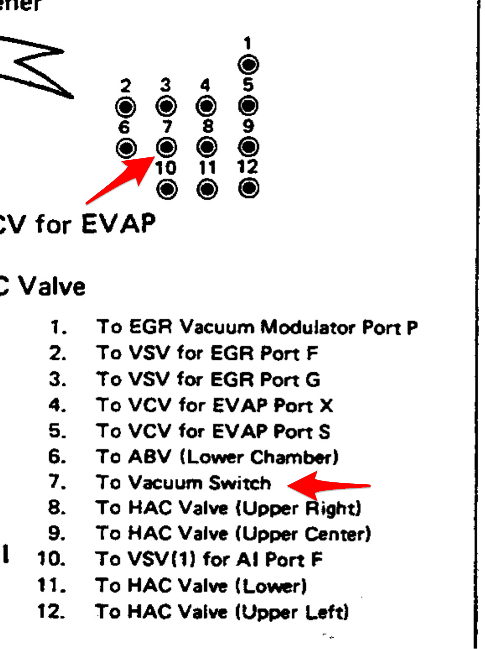

In the spaghetti piping, the vacuum pipe it should connect to is no. 7 in the drawing
Thanks @OSS! Clearly I had my eyes on the wrong thing. I had that vacuum line hoked up correctly. I just pulled the vacuum for the sake of the picture.

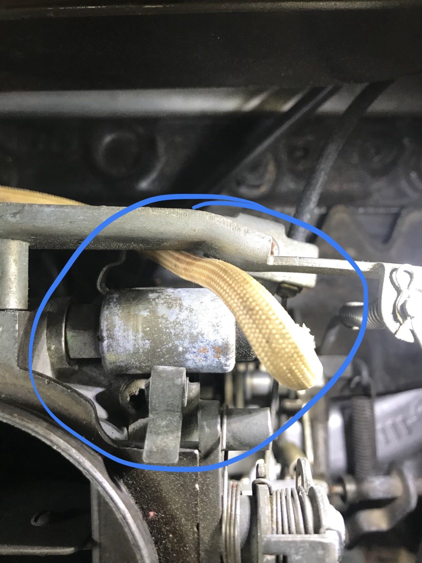

So here’s the latest. Ive been working through the testing procedures. I unplugged the solenoid valve at the carb and the engine did die. So that makes me think it’s working right?
Just to be clear this picture is the solenoid that I need to rest further right.
Yes the fuel cut solenoid is working (that's what may be causing the idle oscillation).
What I [think] is happening (I could be wrong) is if the vacuum switch is dead or wire not connected, the emissions computer thinks you're decelerating above 1500 rpm because it isn't getting a vacuum signal from the vacuum switch, so it turns off the fuel cut solenoid to reduce the fuel going into the carb (which is good during deceleration). Then when the RPMs drop below 1100 or so (cuz the engine is starved of fuel), the emissions computer turns the fuel cut solenoid back on.
With a high idle set, it'll continue to oscillate like that until kingdom come if the vacuum switch is dead.
@OSS I think you are exactly right. Last night I adjusted the idle speed down to around 900 and it hasn’t been doing it since. It does seem to go completely silent when I’m braking although the RPM’s don’t drop like they did before. I think that’s what suppose to happen if the fuel cut solenoid is working so maybe this was all because of the really high idle set. Makes total sense now! Thanks for all of your help!
