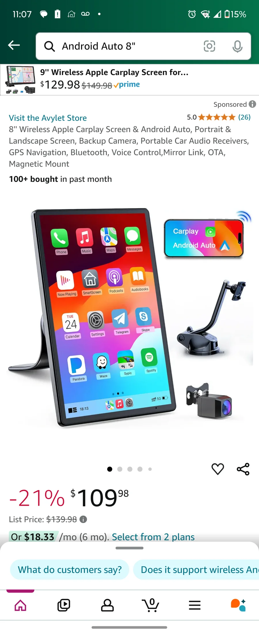

So remove the screen and replace with an 8" android auto tablet. If you need more space for the wiring harness (which are super low profile, btw), remove the front board. Run a hardwired backup cam and plug it in. Keep the vais or bttoy45 connected and route the audio from the tablet to that adapter, then control your music via the tape deck controls. HVAC buttons should still function normally. With the exception of fade/balance and rear HVAC, you have a fully functional (albeit somewhat "farm engineered") android head unit.
