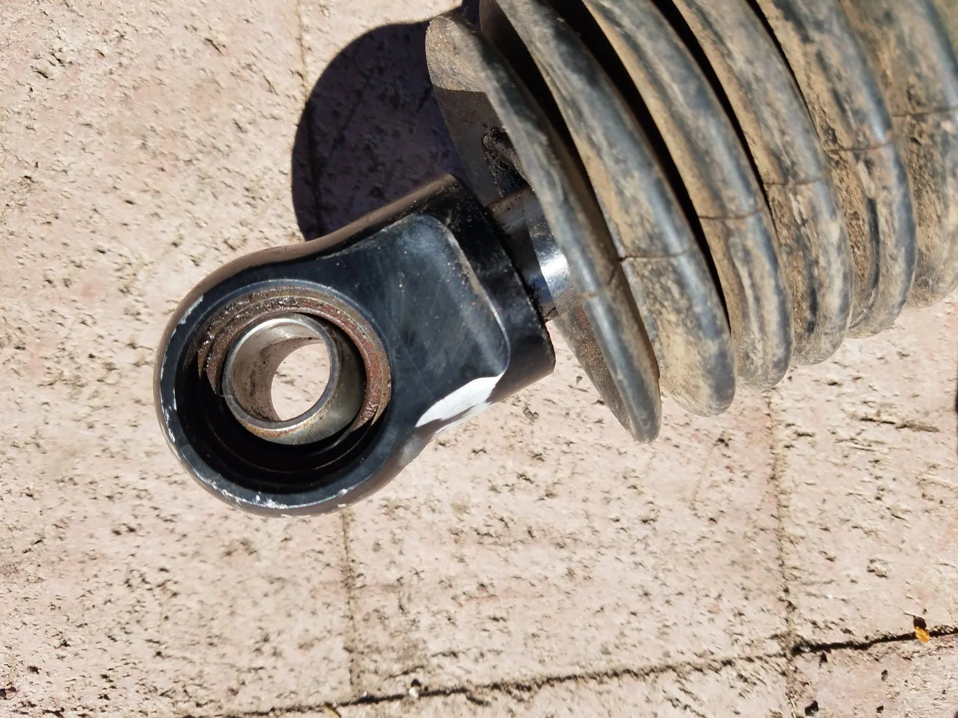

I thought I was making a long-term investment toward a compliant, flexy responsive and comfortable suspension system by throwing a lot of cash at my extra heavy 100 in the form of aftermarket control arms, front and rear, heavy springs and large diameter shocks.
Since nearly day one I experienced an annoying clunk in the rear that I finally traced to a poor fit between the stock bolts and the mounting bushings on the rear of the lower rear end Icon control arms. The bushing ID is too large allowing for excessive slope and the clunk. I believe the fix will be to source appropriate-sized bolts to replace the factory bolts even if that means redrilling the axle housing mounts.
Less easy to fix are the loose heim joint mounts on the front Icon shocks. The ball's are loose in their fixture. See attached photo. This resulted in a progressively worsening rattle from the front end.
The shocks have about 40k miles.
I'm waiting to hear what Icon has to say.

I'm sorry John, you learned a hard lesson of buying these Gucci shocks. While they're awesome for race trucks where they get rebuilt after every race, for the rest of us mere mortals, they just get noisier due to the road grime ingress from daily use. I believe you can buy the correct OD/ID heim eye from online sources that fits your bolt OD perfectly. But, they really hate moisture.

I did hear from Icon -a terse message providing part numbers for the lower mounting components. I'm surprised that a Heim joint wears out.
And I'm not sure how to evaluate the condition of the internals that I did expect to need service...

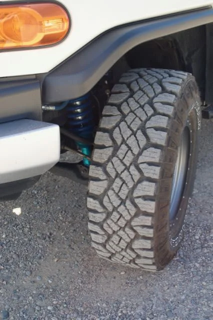

Look at that pretty blue peeking out:

A friend had a 2nd Gen Tacoma with Icons all the way around including the billet UCAs. He hated it. Kidney buster he called it. That was just driving around town. He loved riding in my FJ and wished he had gone Kings. He eventually did.
