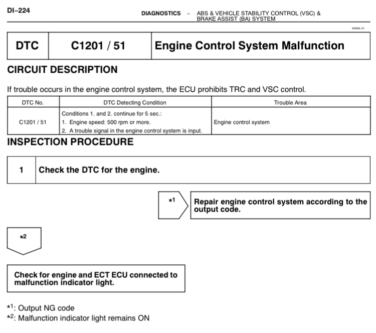

the CEL and the VSC lights go on no matter which ECU has an issue.
That’s not true. The CEL only comes on for engine DTCs. On the other hand, the VSC/ATRAC lights will come on for any of the ECUs. If your CEL is on, then you have an engine DTC, and as the FSM diagnostic I posted above says, you need to resolve the engine DTC first.
Why centering the steering wheel would affect the VSC ECU is beyond me. But the ABS light does not go on so if it is the ECU it is only one section of the board. I scanned the thread on replacing the resonators but I have no idea if this could be my issue.
Stop worrying about the ABS/VSC for now - the C1201 code is generic and doesn’t necessarily mean anything is wrong with that system. Your issue lies with the engine. Fix that first.
Thanks- I had not understood that the CEL only comes on when there is an engine issue-- now I understand that the VSC/ATRAC can come on anytime that there is a DTC in the system but the CEL always points to a possible engine DTC.

Junk-- you were spot on-- pulled the engine DCT's-- and I got lucky- just the normal PO442 and PO456 codes.
I am hoping it was just my new fuel cap. The seller had put an aftermarket new fuel cap on but because it was making a honking noise when I parked the truck I replaced it with was represented as an OEM Factory fuel cap.
The OEM cap never made honking noise but perhaps honking is a good symptom. I cleared the codes and installed the old non-OEM cap and we will see. Five miles down the road and no CEL so far.
