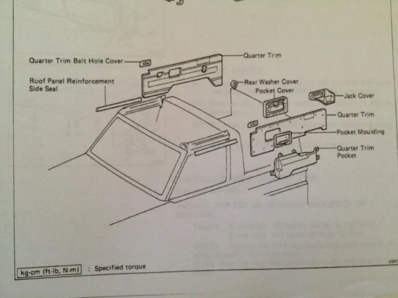

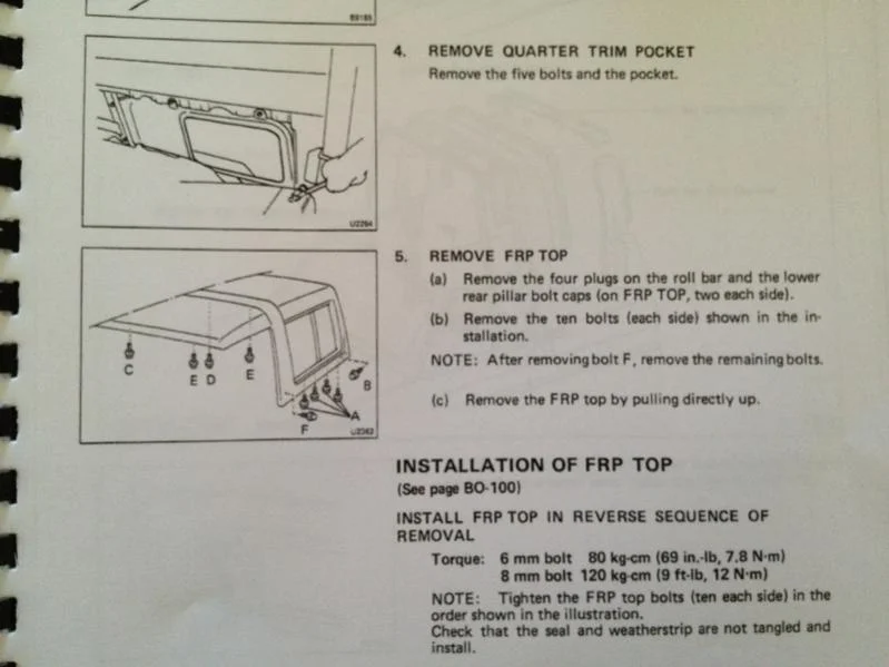

Hi.
My mate has rust under the A pillar of his landcruiser HZJ73, & we want to remove the fibreglass roof to gain access to the rusted area.
Has anyone removed their roof or have any pictures or diagrams of how this is done?
Ive done the same thing on my LN60 Surf & someone had a diagram from a factory Toyota shop manual.
Any help would be appreciated.
Cheers
Lots of hardware all over the place, but "secret" bolts under the FRP emblem right near the B pillar.
~John
andy1 said:
Hi.
Cheers
Not sure if this will help but it's a start.
