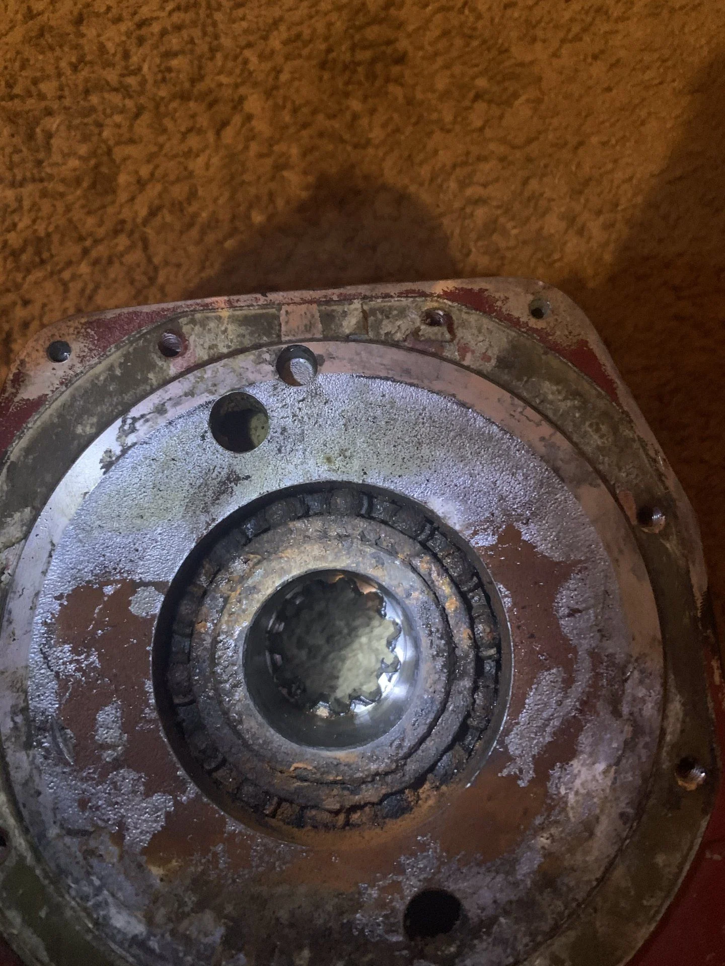

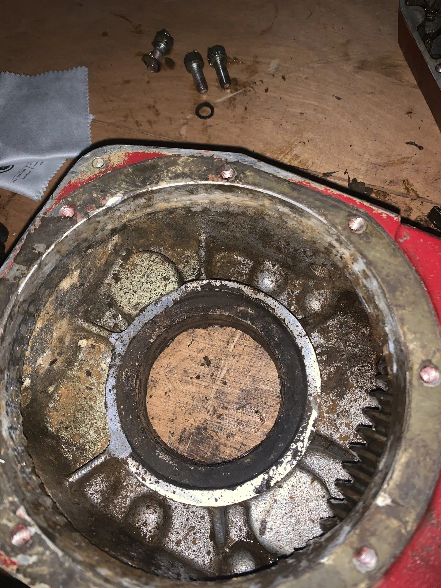

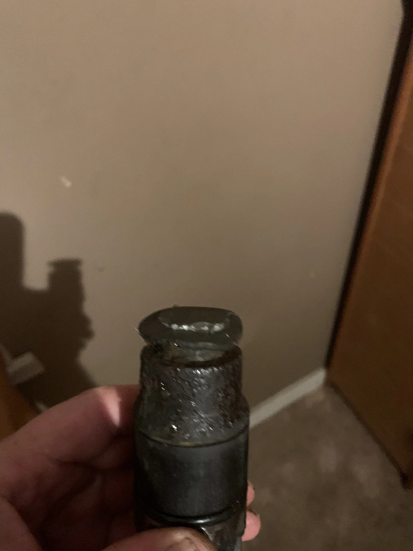

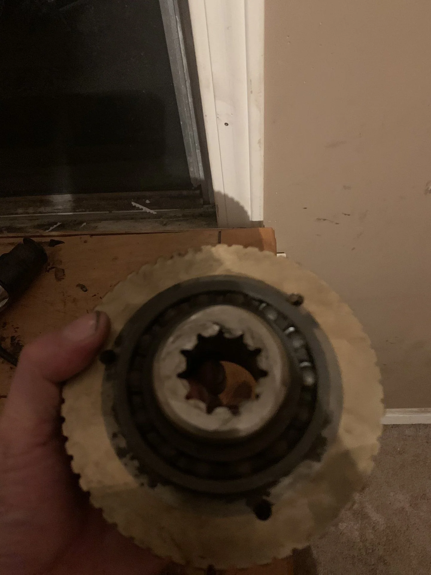

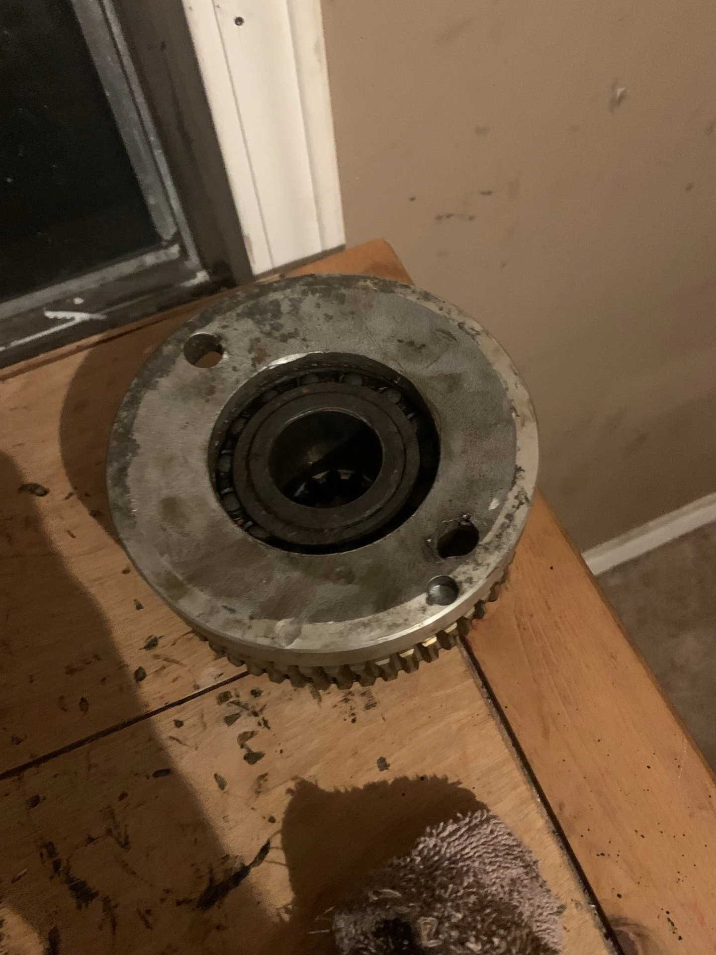

Wow, yours looks so much cleaner and nicer than the one I’m working with! Lol, my lovely Husky I ended up getting had the unfortunate fate of being mounted to a car trailer in north Mississippi.
I simply must know what the procedure was to get the gears and bearings apart and out of the casing
my shaft end ended up getting bent by having to hammer it out(it was THAT corroded)
I then had to hammer from the backside to force the gearing assembly up high enough to clear that cover coming out
man I’m gonna have to have some machine work done for sure
lol I’ll have pics up in a bit
