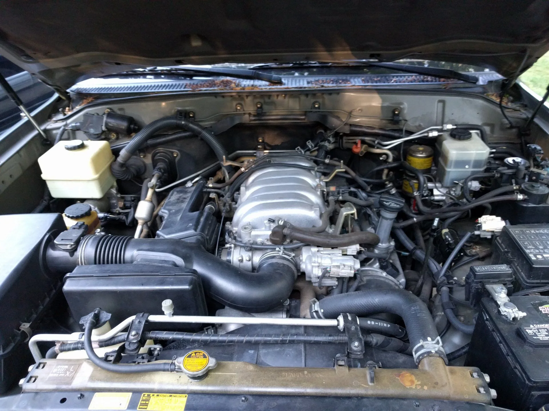

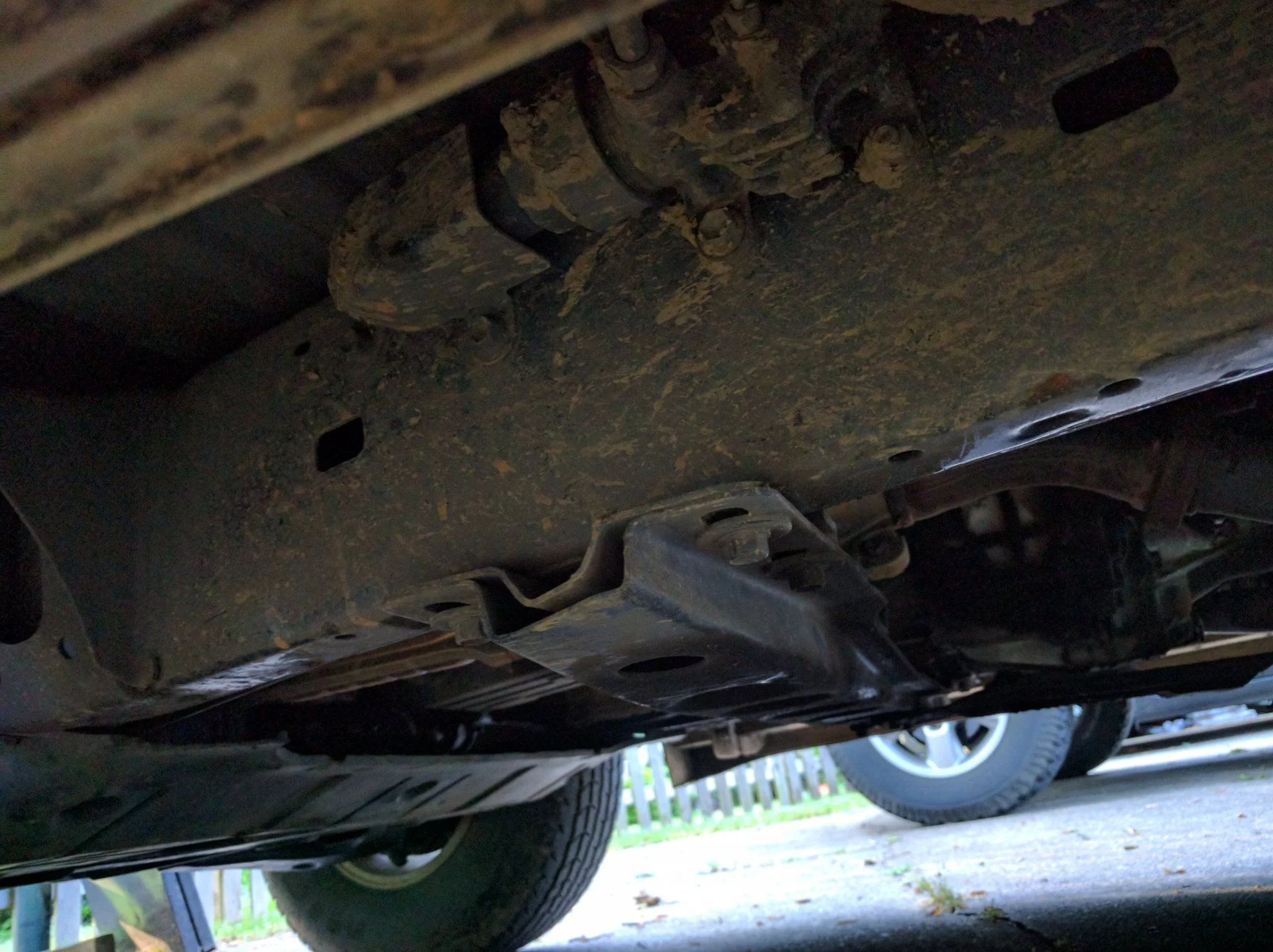

You can also ask for under hood pictures, ahc will have a reservoir on the passenger side fire wall. Or underside pics, there will be spheres and hard lines asking the frame rails.

Rail:
