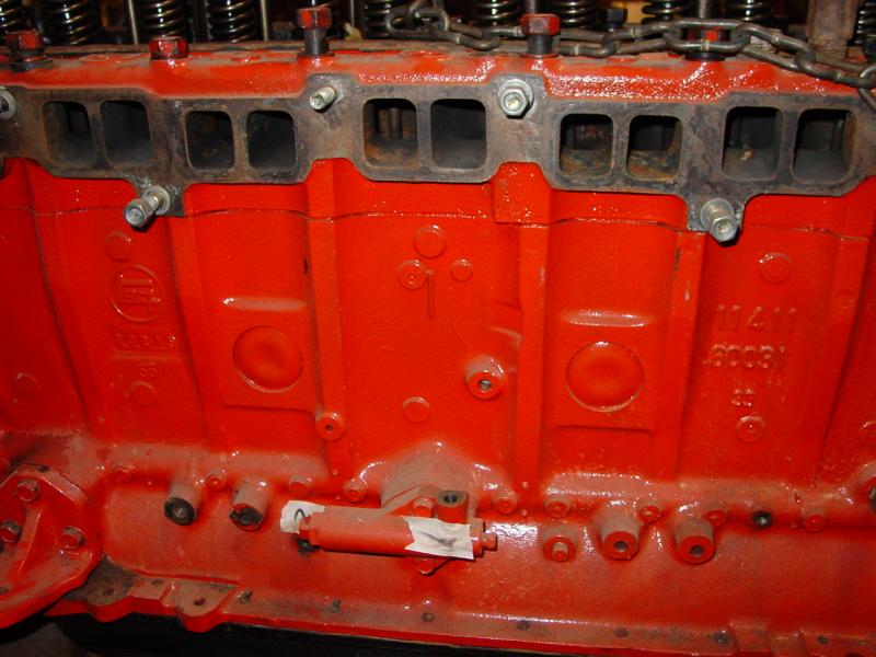

one of my customers pulled his 40 out of a shop after they had it for two years to "rebuild" the 2F in it. head gasket was on backwards, they moved the valve train "bosses" around so no oil got to the top end,......real experts.

I actually serviced one of those 'beat on sideways' rocker arm hacked 2Fs while I was in Atlanta on vacation before GSMTR last year.:rolleyes:
One day Jim, your gonna have to come by and see the Mark's Off Road "Wall of Shame" collection of stuff I've pulled off of crusiers. Hell, between you, me and Whatley, we've probably got enough bastardized parts to build a rig that would scare Frankenstein!:eek:

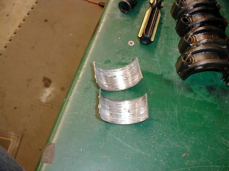

when changing to hei, don't bother using the gm hold down, just use the stock hold down even if it's loose and allows the dizzy to slip up out of the pump shaft. all that oil makes your bearings slick and they might slip. you really need bearings with traction, like these ;)

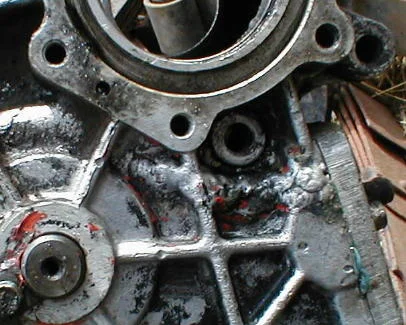

and to go with all of this, a split case to put behind the tranny. if oil seeps through your booger welds, you can coat on a couple of tubes of orange permatex.
