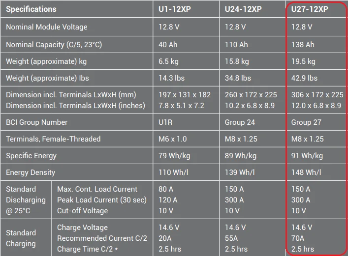

The battery max continuous load is 150 Amps, but I was unable to find a max "c" rating for discharge, but I did find a c/2 max for charge.
The battery (Valence U27-12XP) I had tested and it's still at 100% and 138 AH.

I found this spec sheet. As you said, 150A max discharge with 300A overload for up to 30 seconds.
That would allow just under 2000W AC power when the battery is fully charged, and about 1600W AC power when the battery is low SoC.
On the charge side, 40A is under the C/2 max charge rate so you should be good.
