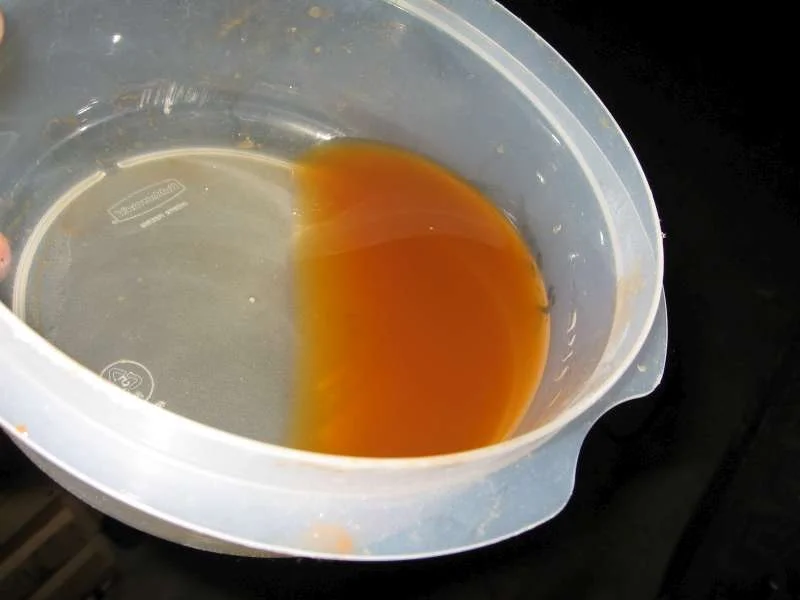

The stuff that came out... isn't water. It smells vaguely dieselly, but its thicker than diesel, and orange. Its about what I'd expect WVO/SVO or bio-something might look like. Does the sedmimenter trap VO if the PO was using it before I switched back to dino diesel?
pic of "drainage":
It traps anything that is heavier than diesel. If it goes away while you use dino fuel ,you will know it was the bio.
Shouldnt need bleeding
