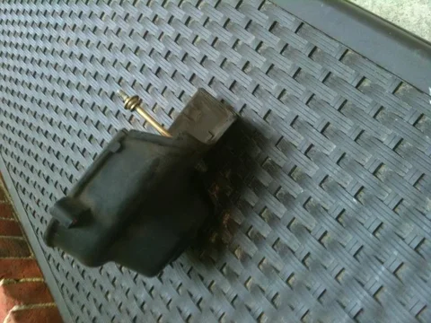

This is the dustcover off the '03, perhaps the same as the 04. (my '99 cover differs in that center bolt stud remains connected to block not dustcover, with removable nut). I posted last week on this-removing the serp belt helps quite a bit for clearance on removing bolts and the cover, and really saves you time IMO. 30 minutes total for entire inspection. I inspected both my 03 and 99 this past week.
After removal of cover, I put serp back in place, cranked engine for split second and rotated entire belt in increments to view in entirety. The OEM belt on my 99 is now 7 years old, 115k , all driven by myself and in like new condition- gonna risk another year.
