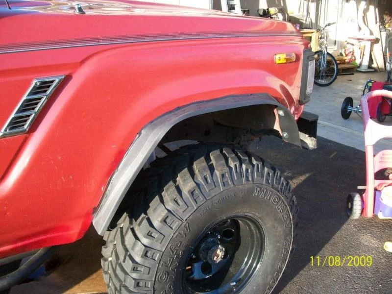

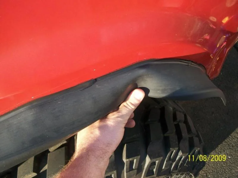

I went really cheap here, just trying to get passed inspection. I bought some rubber carpet trim fom Homie Depot for 2.97 a piece, and a tube of black caulk. I had some hex head screws and washers laying around. I needed 2 1/4" of flare in front so I stuck the out about 2 3/4" to make sure I pass the inspection. The trim comes in 4'x4" lengths, witch was really too short so I'm not sure what they're gonna say at the inspection station.

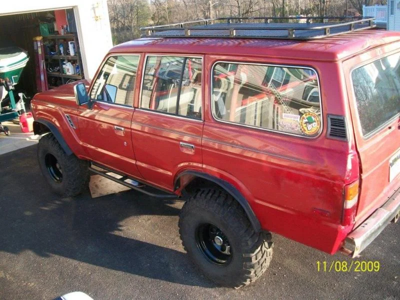

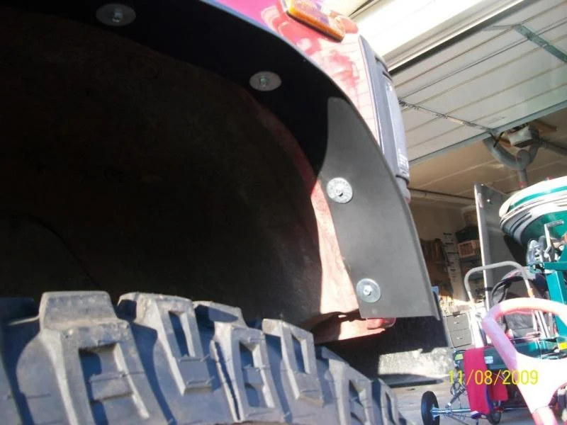

If I get too close to a tree or rock on the trail they should just bend out of the way. maybe bending armor around the wheel well and filling in the space between the body and the pipe would have been a better solution.
nice job let us know how it goes at the inspection station
It passed!! The red onion lives!
My wife just got back form the station in middle way. She said it was only like 10 minutes. She said she's not sure they even looked at the flares.
