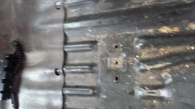

Should be troop seat compatible. Look for the 4 attachment points on the rear floor
Pics with and without the hardware

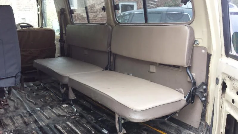

I think the 75 series can come with no accomodations for a rear seat, in the EPC there is a part number for a rear floor pan and floor members W/O rear seat. The seat belt for the bench was a shoulder belt and attached to the side of the truck and to the bench seat its self.
As far as the plate on the wheel well, the plate is there for the bench seat if it is installed.
This is some pics of the set up Phrog is talking about.

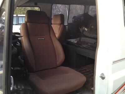

Could it be that in the '00 and on that RV signified a 5 seat configuration, being a swivel seat LH side to access the rear bench tumbler?
Mate in Oz in the RV business seems to think differently, not recalling any Troopys that had a "slide forward, swivel base".
Where the notion came from:
"The rear seat is very bench-like, however it will allow three adults to travel in reasonable comfort. The front passenger seat can be moved forward and swivels with a one-lever action, to allow access to the rear seat."

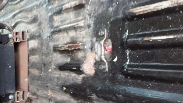

sorry to dig up this old thread, but i'm currently trying to convert my 6 forward facing seater into an 8 seater with rear benches.. and my 1HZ-RV model 1994 doesn't have any of the mount points for them.. nothing in the side wall body or floor..
@PhrogsPhorever it looks like you've had to make your own plates also? did you happen to get any measurements on the plate sizes behind say the top seat mounts in your photos, and how you made up the 3 point fixing near the rear barn doors please?​
