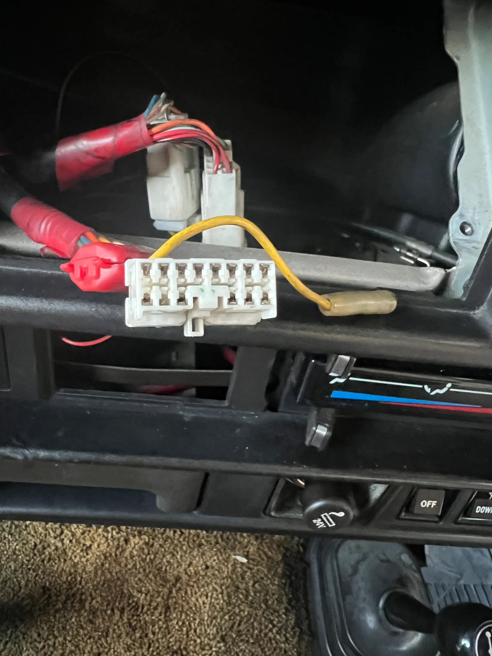

Hello there are other threads on this but most are very old and some are making my head spin or seem to involve people trying to do complex setups. Though if I'm missing one I'm happy to be redirected.
I bought a new alpine double din touchscreen head unit to put in my HJ61. Yes it is a 24V truck, but the head unit says 12V so I am assuming I have the in-dash converter.
I am trying to see if anyone is aware of what adapter I could buy to allow me to simply plug my stock wiring harness into the modern head unit.
Alternatively if no such adapter exists, if anyone has a wiring diagram so I can hardwire the stock harness wires to the harness that comes with the new head unit that would also help as I can't seem to find a clear answer on this.
I will include pics of my stock radio and harness so it is clear which audio setup the truck has from factory.
Years ago I wired a single din head unit into a corolla and that's the extent of my wiring and audio experience so I'm noob level. Also i am selling this original HJ61 radio if anyone is interested in buying it. But it was not fully functional when I pulled it out.

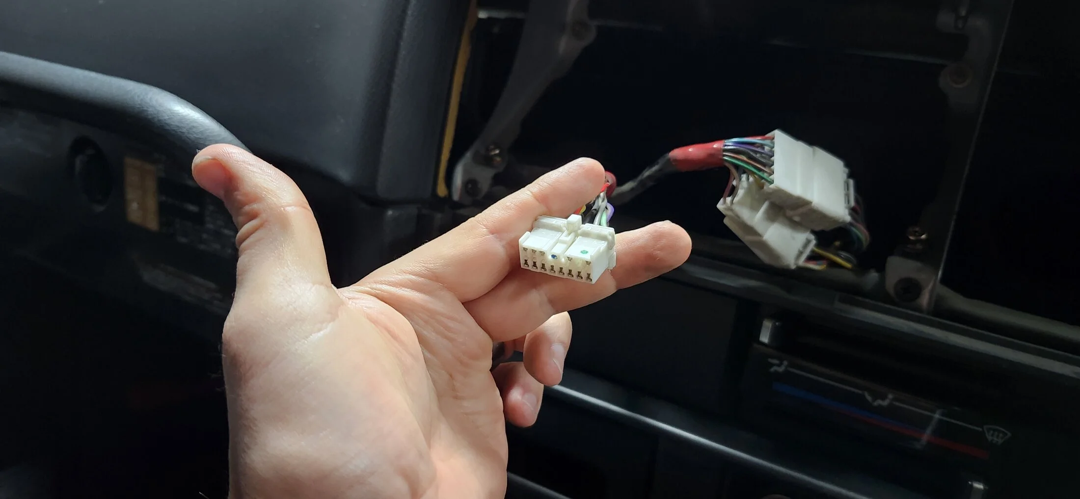

what did that connector in your fingers plug into ?
Factory head unit. But the "premium audio" one not the standard 60 series style.
can you show pics of what that single plug plugged into ?

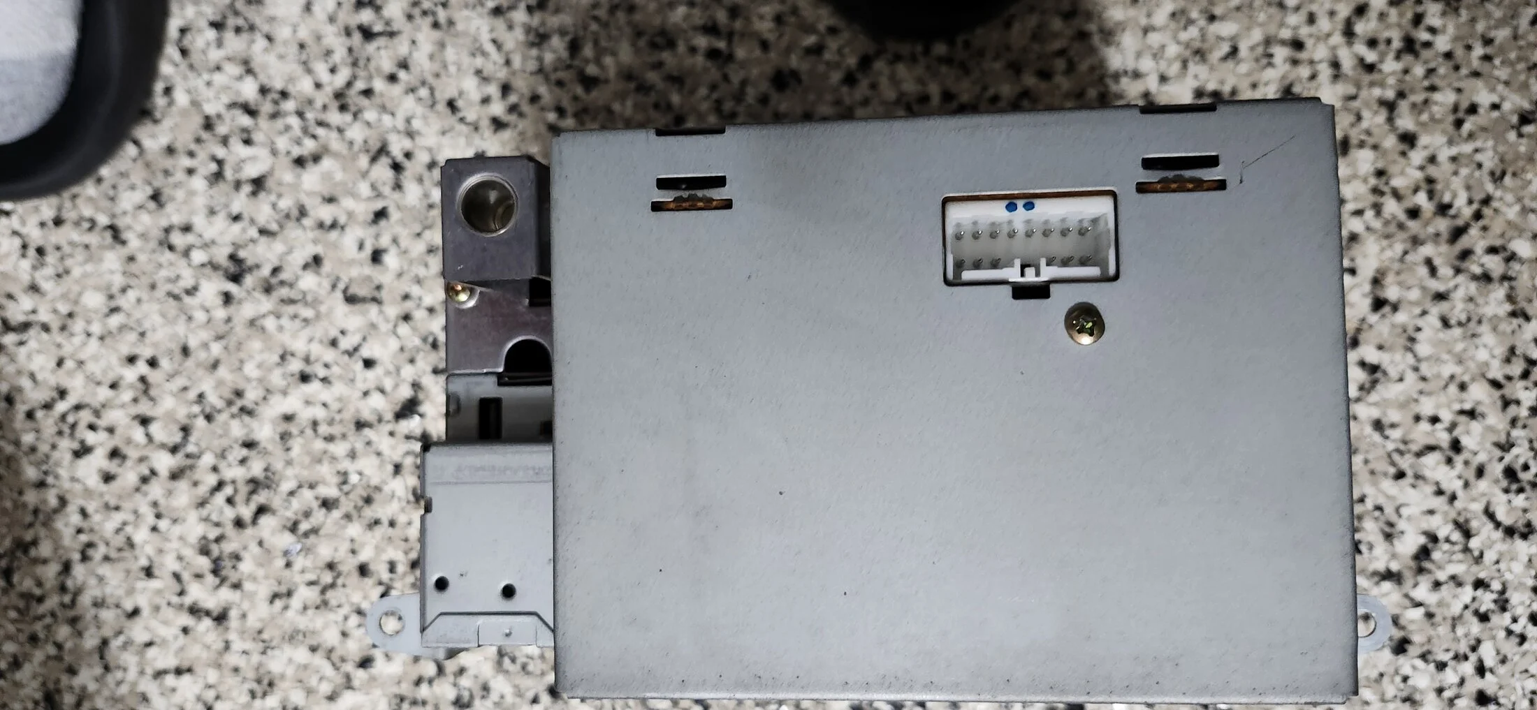

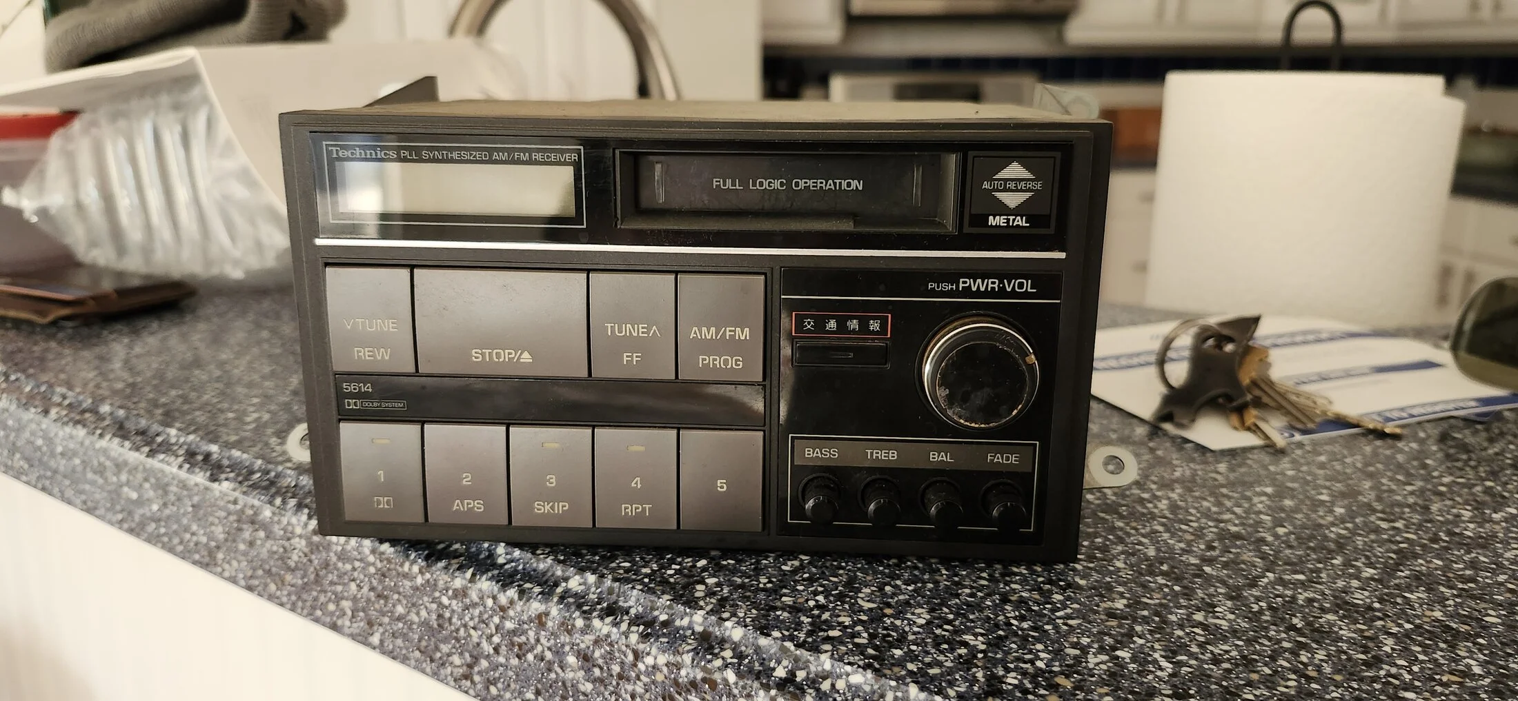

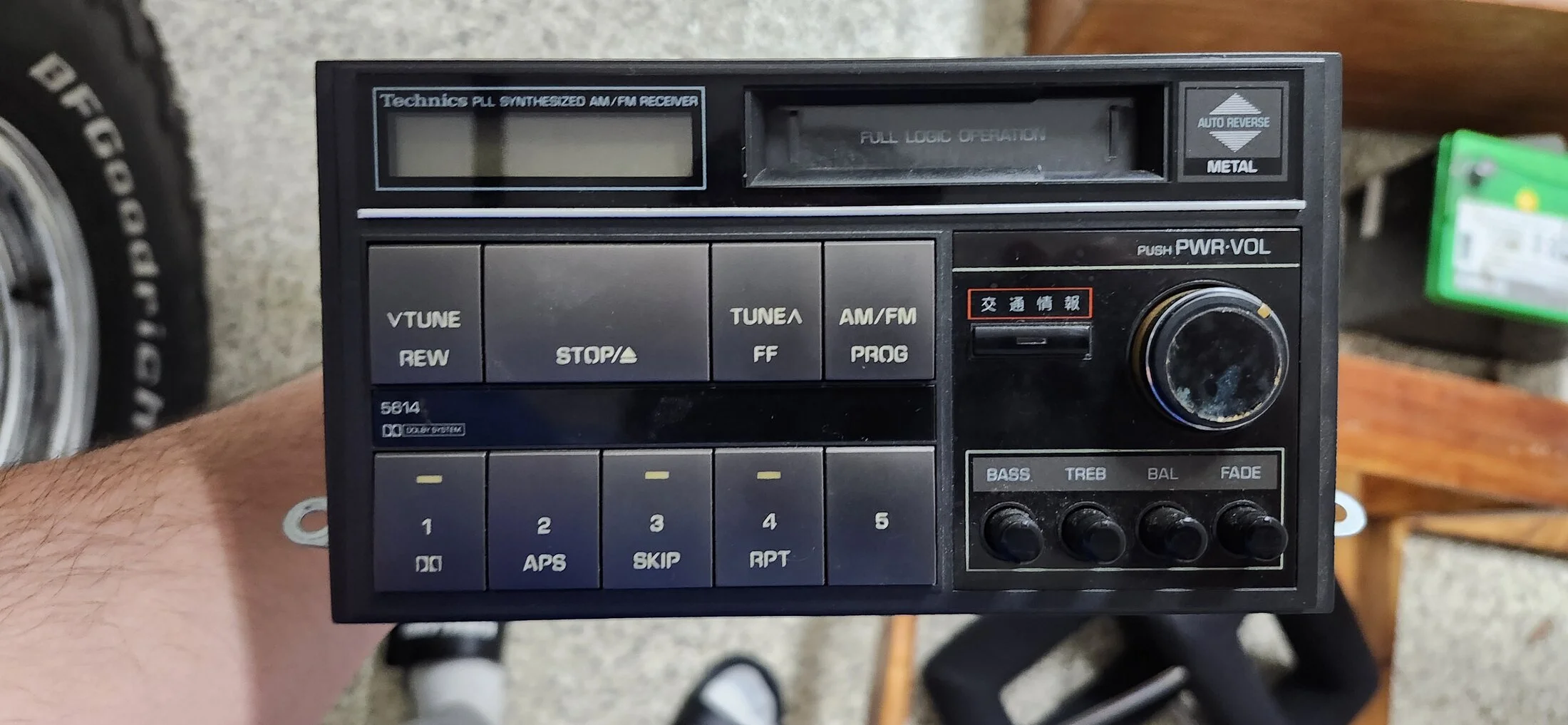

Sure here is the old radio front and back. As far as I am aware, this was also in some 70 series prados.

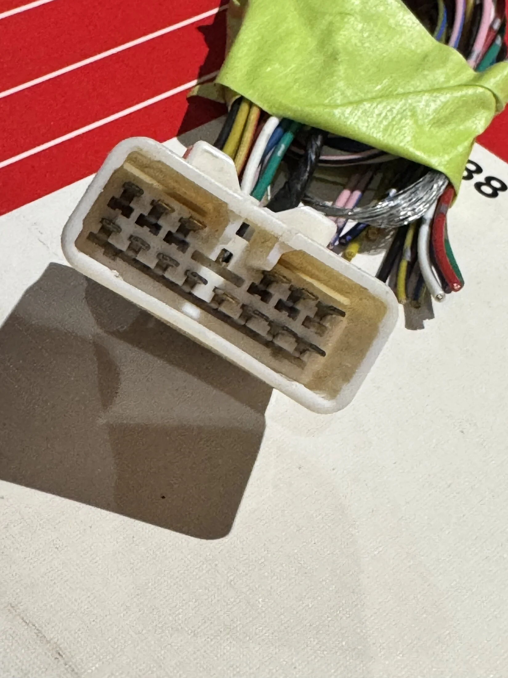

The single plug in my hands in the original pic for this goes directly into the slot you see on the back of the radio. That's the only radio. Just one plug that plugs in. Those other two you see further down the line still connected may or may not be the normal 60 series dual plugs, but I'm not sure if they are and not sure it would matter.
since this is a 24v truck there is a factory converter further in the dash that all these wires run to. That drops it to 12v so the radio can run. But a multimeter showed that the two dual plugs produce 24v. So even if they are the normal style plugs they are prior to the converter and therefore won't work for anything 12V. So that 12V 14 pin plug you see me holding is the only plug/harness i have to draw from. And as stated, the only plug on the radio other than the antenna wire.
I am trying to replace this setup with an Alpine new touchscreen unit. I have searched for an adapter for this plug or wiring diagram for this setup but they don't seem to exist so I have no idea what wires are what.

Yes I am familiar with how the aftermarket radio end will work but the issue is finding out what the setup on that plug is. The 14pin connector from the truck seems like a rare item.

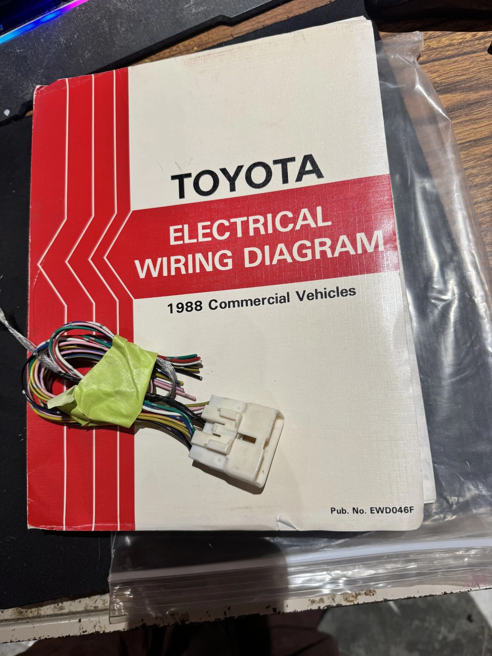

It has 14 pins which.....seems to be correct. I'm not aware of any other time toyota used this 14pin connector in this era except for this radio. Does it exist in the wiring diagrams?

Never found any adapter that was definitively going to work. There is one sold in the UK i think that LOOKS like it MIGHT work but it was like 50 bucks so i didnt want to risk it only for it to not work.
I ended up just having to cut the whole thing out and hardwire everything. Tested the various wires with a continuity on a multimeter to figure out what went to what, etc. Just got rid of the entire built in amp/converter under the dash because dealing with it was insane.

I used two diodes to fix the parasitic draw issue and install a normal modern alpine touch screen unit. It also retains memory.
There is another thread on here about how to do it, complete with a wiring diagram. I think in that mudders case it was a 70 series but same exact situation. If you cant find it yourself i may be able to when i am home later as i am out on my phone right now doing stuff.
Search "24V radio memory" or something because it was a guy with a 24v 70 series who wanted to prevent drain from memory draw if i remember correctly. Could be wrong about that. If you have a 24v cruiser like me youll also need a converter.
