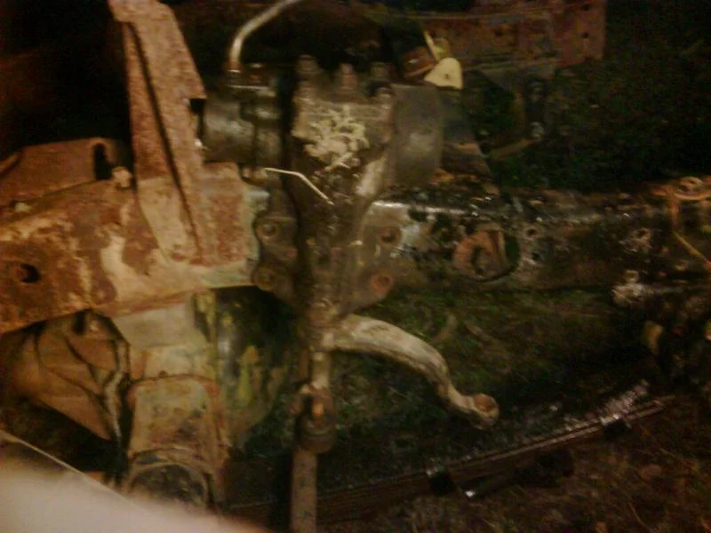

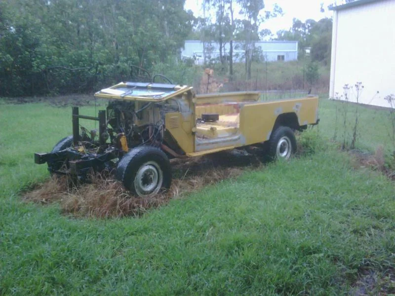

Hey guys i have a love affair with my troopy it was my first 4wd but as such it has died of the cancer i have more than enough parts to get her going again but id like to make it alittle more special than standard. Like every one now days my minister for finance wont allow to big a spend as troopy’s in oz are common and cheap so i wouldn’t wanna blow all my money on a car worth 2 to 3 grand.

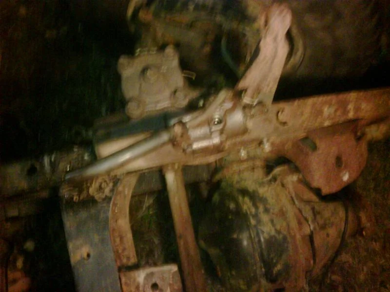

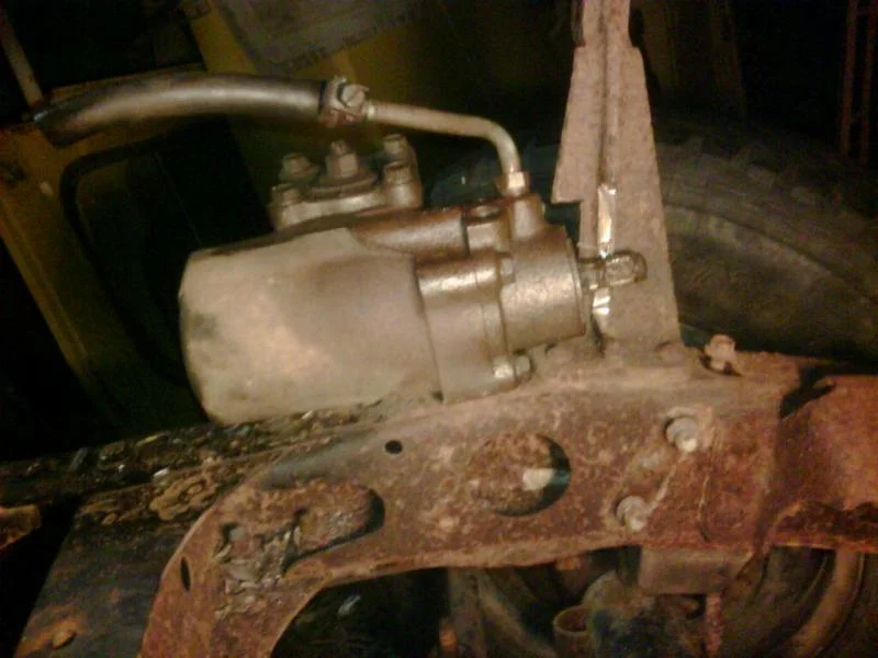

60 series power steering is pretty cheap ... especially here in oz. Parts are plentiful. Relatively minor modding is required, from what I understand - you'll need to move your shock tower to fit the steering box. And an HJ60 power steering pump should bolt straight up to you 2H.
60 series springs are a different matter - they are longer from what I understand and therefore that requires moving your spring perches - so once again its minimal cost, but will take a fair bit of time and fabrication.
