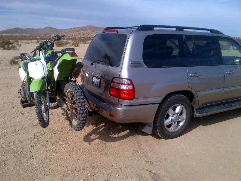

Currently, I use a "moto jack" rack (which carries only one full sized dirt bike plus one mini). It supports the bike at the footpegs, not by the wheels so it sways a little less. I'll still probably try to pick up one of the tightening type products for it. Also, I'll shoot/post some pictures of it loaded over the weekend.

Below is a photo of how my current Motojack rack set up works:
A dual rail set up, like the versa haul link posted above, would be about 50-90 more lbs. (thus, new springs or air springs) and, it feels to me, more twist (which is what triggered my initial question).
If any one can describe how a cable-based method to reduce sway might work, please do so. To me it seems that anything that doesn't provide support from the bottom won't really work (unless there's a way to get a solid anchor for a cable/tie-down way up high).
