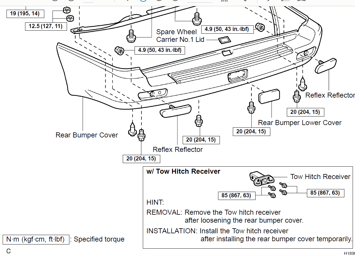

Hello out there. I have a 05 LX470. The truck has a towing package (harness, radiator) but no separate frame rail mounted hitch. The mount for a hitch is on the rear crossmember of the frame
behind the access plate on the rear bumper. I need the torque specs for the 4 mounting bolts that fasten the hitch to the frame. For some reason, dealers are either slow or reluctant to share this info.
Thanks
Tonino
@Tonino I believe this is what you are after...

Perfect, thank you very much. I just printed it for the file. I did look at a diagram before I ordered the part, but it was different and showed the rear axle as well.
If there were torque values on it, the print was so small my 82 year old eyes couldn't read it. The assist is very much appreciated.
Tonino
Tonino
You are welcome. Just make sure to note the order of the torque value units on the diagram. The ft-lbs is the second number in parenthesis.
