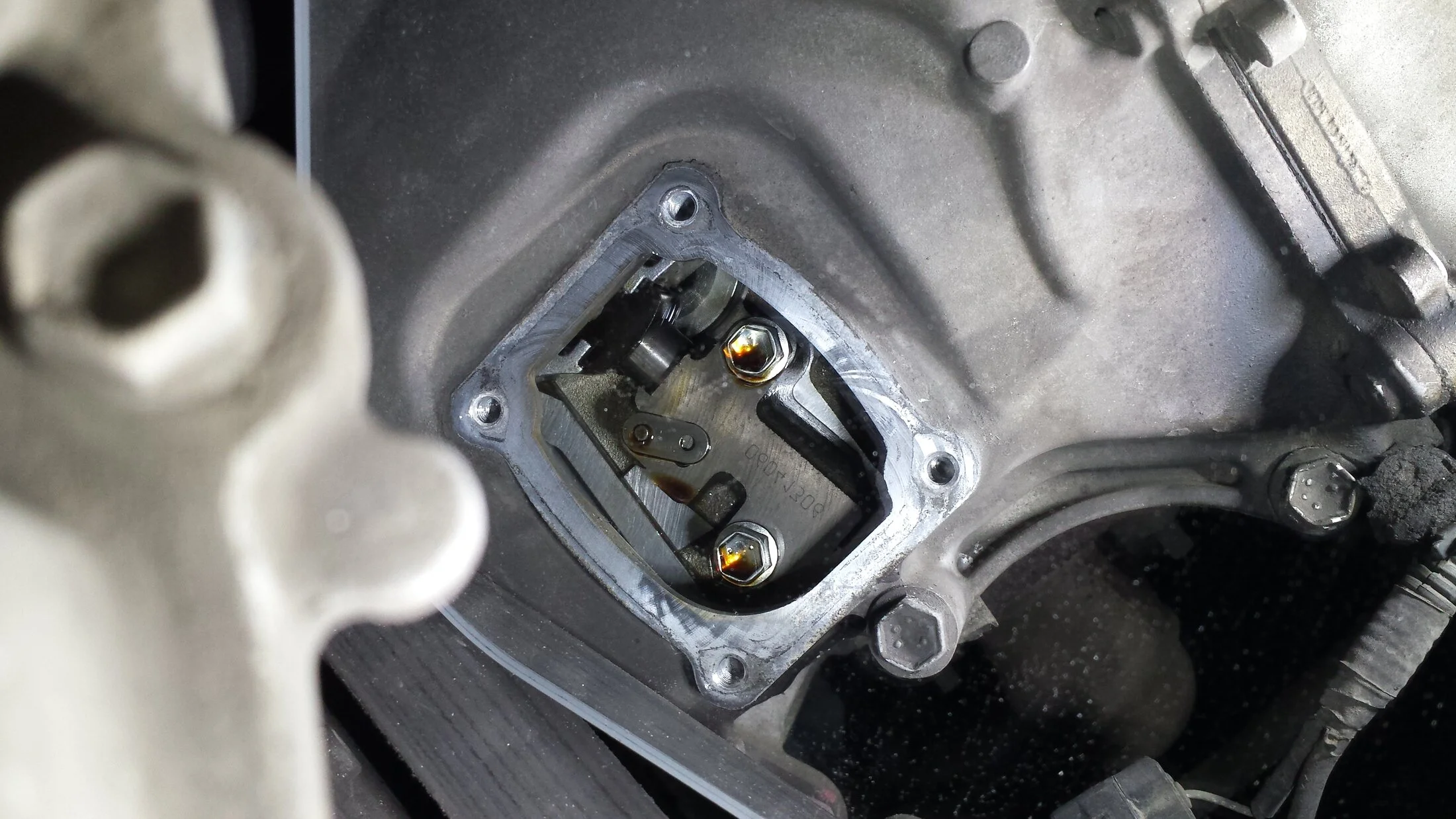

If they’ll let you inspect it, there is a 3 inch square cover just under the right cylinder head on the timing cover. Unscrew it and you’ll be looking right at the main chain tensioner. The plunger on a maintained 1 gr will be sticking out 8-10mm, it’s a ratcheting tensioner. After 8 to 10 you will see rings for each click out compensating for wear. Also you will see if the engine is all sludged up, bad omen.
P.S. mine is at 259,000 miles. The picture is almost upside down, my bad…

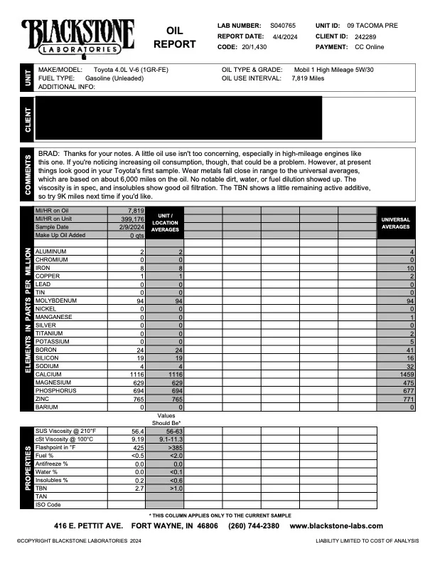

Here is my oil analysis from last year and 399K miles...
