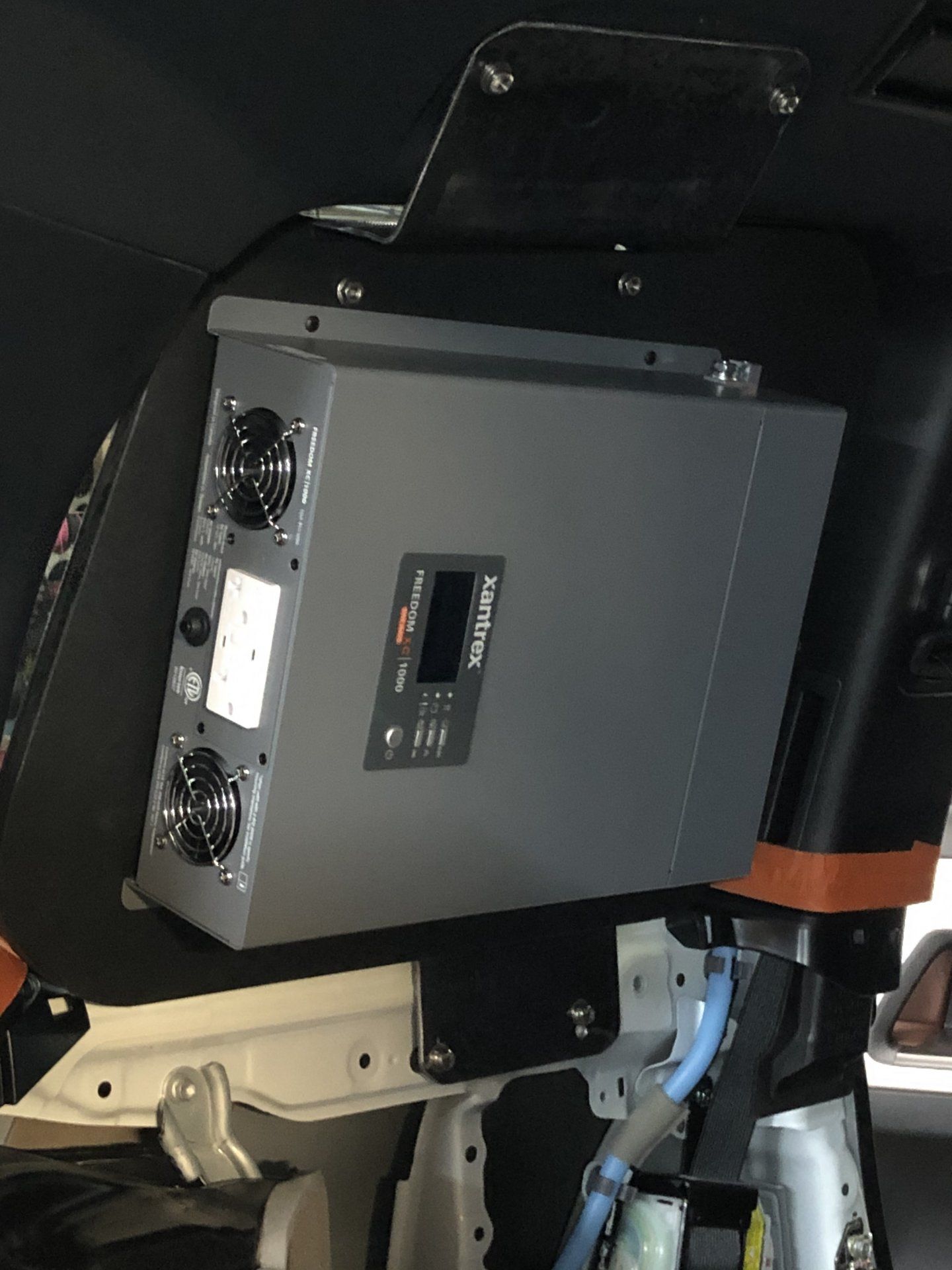

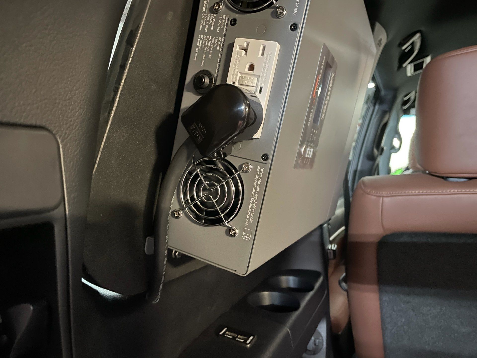

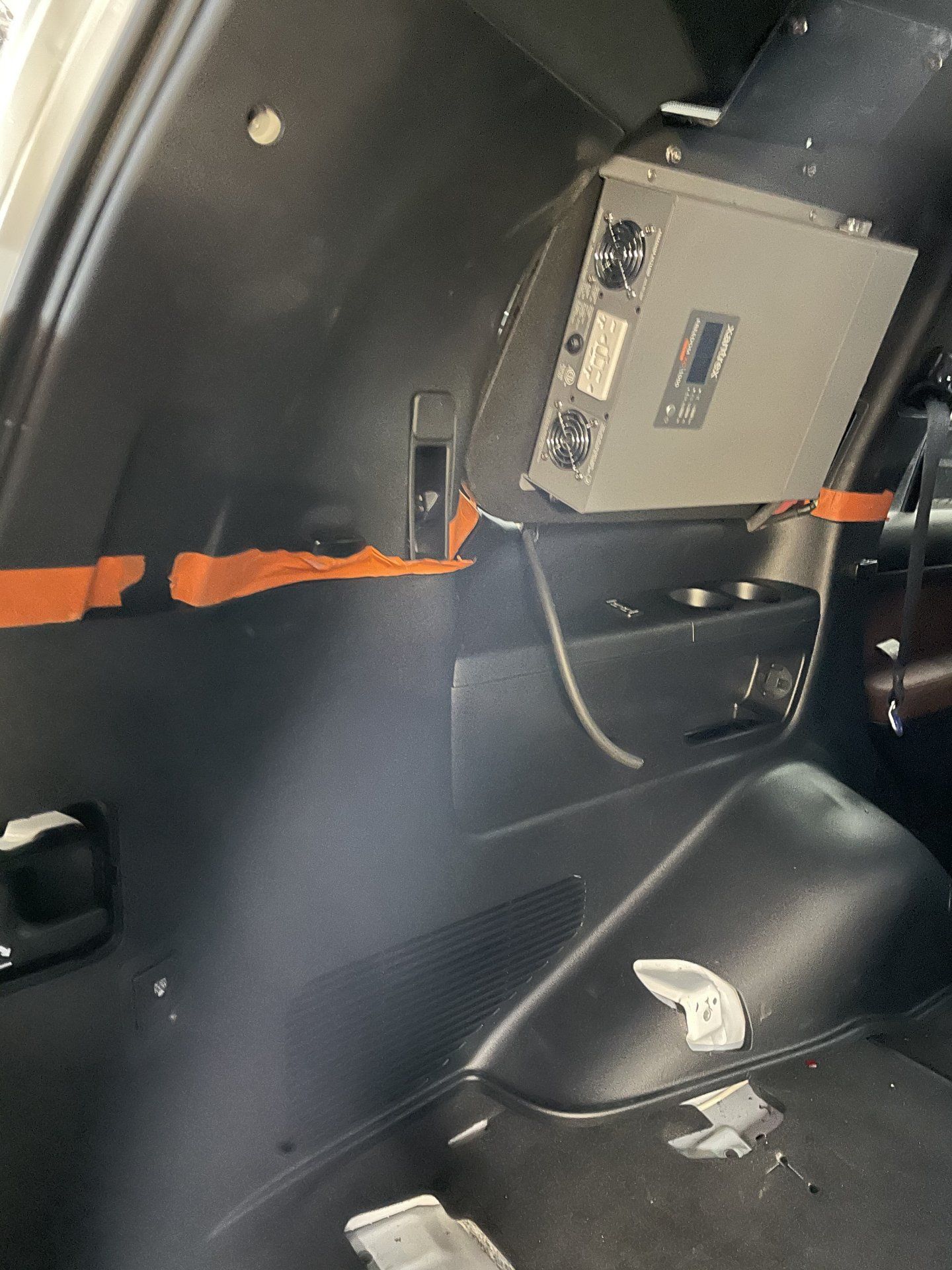

This is our project and mounting location. Apparently this became a huge pain in the butt, but it was a good use of space. Mounted on King Starboard UHMW (Poly). Brackets will be painted etc. Andersen connections for easy removal for service needs etc.
Is that one of those $5k ambulance inverters?
Also, did you ground at the chassis? And what batteries are you using?
Not $5k. But yes. No BS- pure Sine Wave inverter.
The inverter chassis will be grounded/bonded with then body-chassis. #cleanpower.
