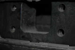

I have a 2003 with the "hidden hitch" and not the standard "under bumper" hitch. I notice 90% of the pitures I see of US 2003's have the under the bumper hitch, but I DO see a few with the hidden hitch cover in the center of the rear bumper on eBay and a few on this site as well on the "picture thread" - but those seem to be more international 100's (Middle East, Europe, Aust etc).
I popped off the plate and there is a 2in. square reciever that seems kind stout.
Couple question...
1) Anyone know the tow rating of this? Probably lower than the under the bumper one I'd guess.
2) There is no hole in the side of this receiver to stick the hitch pin into in order to secure the receiver hitch... anyone know if that is the way to go about this?? OR, there are 4 bolt holes around the receiver hole, do I need to buy some sort of "converter" to use in order to use a stadard hitch?
Don't worry, I only use it to tow maybe 1000 lb max (1 small dirtbike) so no need for a big hitch capacity right now.
Thanks again all...

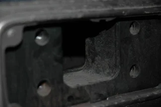

I looked hard, but there is definitely no place for the pin to go through. There must be some sort of insert/adapter or something needed??
Here are pics... you can see all the way through to the spare and there are no holes anywhere on the sides, top or bottom.. hmmm :frown:

You have the exact same square hole as I do in my rear crossmember. There's a hitch attachment that bolts into those 4 holes. That attachment is the "receiver" that a normal hitch fits into and should have a hole for the pin and hoops for the chain. You need to get this from the dealer. I don't have one, but I know they must be available since I saw one LX in town a few weeks ago with one installed. It's also pictured in the FSM in the body section.
The in-bumper hitch is rated at 5k lbs.

Reminder: For those who have built-in square hole like you Fish4live, the four holes about 1/2" wider than standard four holes.
We learned that when we ordered one and put in our standard rear crossmember during out custom armor rear bumper that have four holes but no big square hole in it and the holes didn't aligned up.

The square hole is wider since the 2" receiver fits inside of it. Make sure you get the OEM bolts. The torque according to my FSM is sixty-something ft-lbs. Kind of low, IMHO, as the torque on the drawtite towbar that bolts underneath is 115 ft-lbs.
