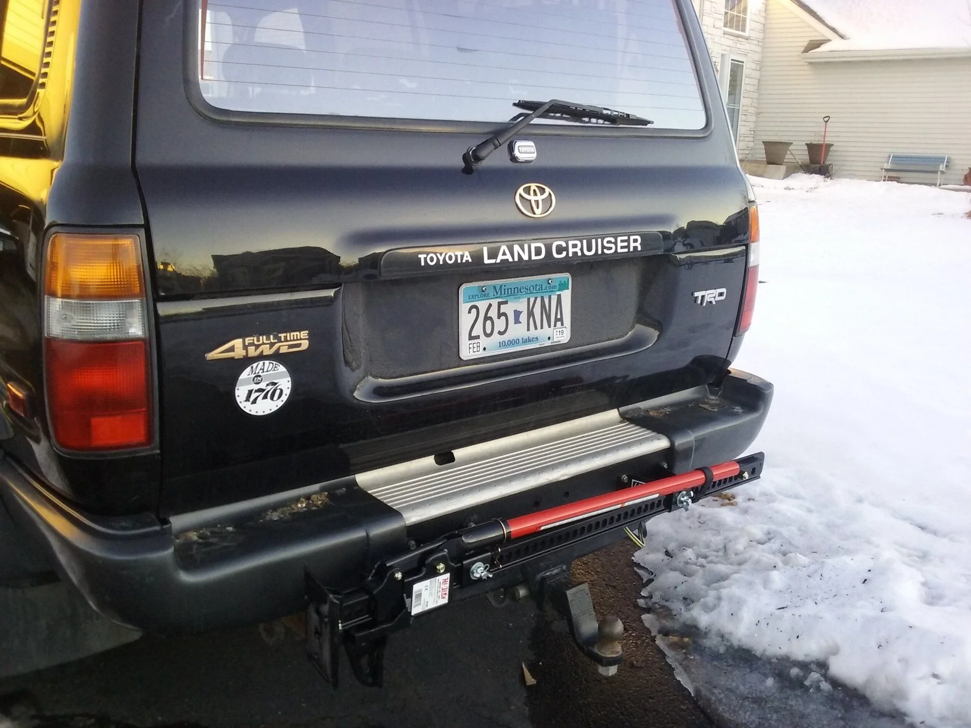

I chose a more simple approach, no welding:
Nice work. Did you consider using a standoff mounted to the the factory pintle bolt holes?
