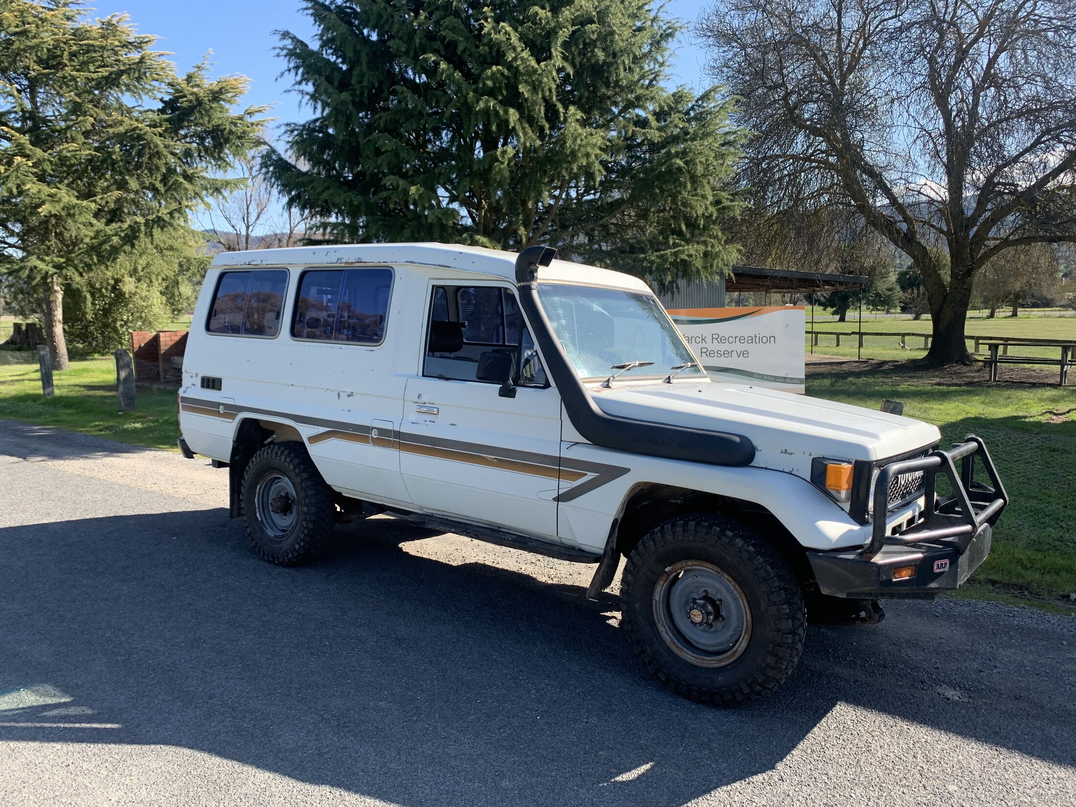

Hi there, Aussie here with a 1989 Land Cruiser H75. I've owned it for about a year and just had the gearbox reconditioned and a new clutch kit put in.
Curious from others who have had gearbox done on a similar age vehicle, how smooth was the box after recondition? I was expecting it to feel a LOT smoother, but still kinda crutchy going into some gears at certain speeds, as well as this new deep whorling sound in third gear. Before the recon I had this higher pitch whirling sound in 4th and 5th under load which is now gone thankfully. I am just trying to gauge with others as I've never owned a car this old so not sure what to expect after a recon
