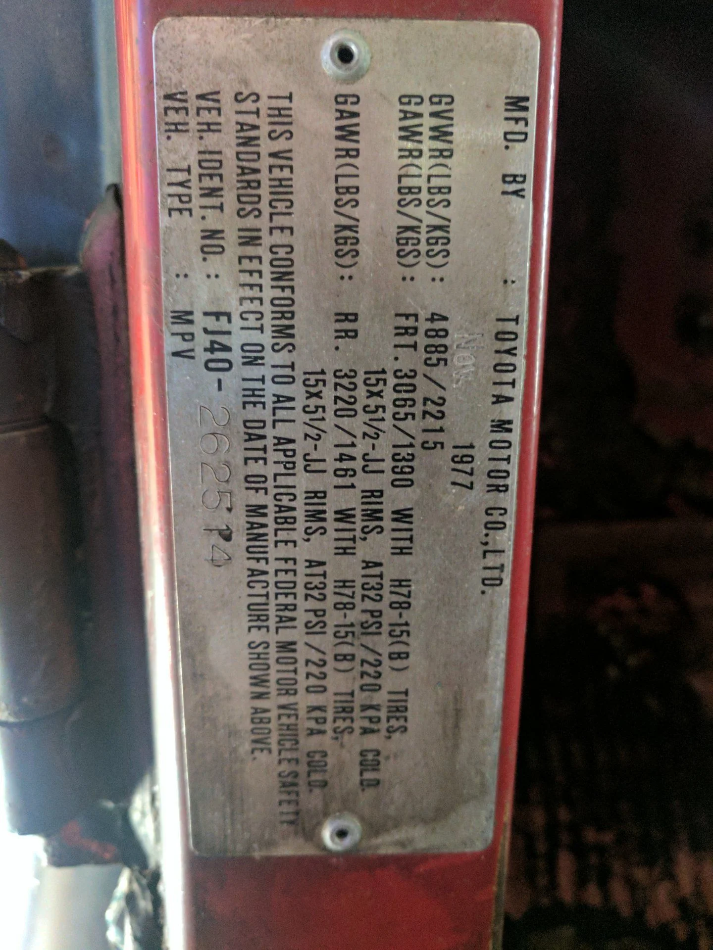

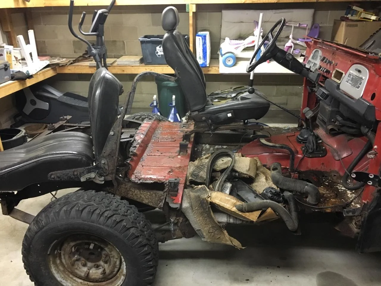

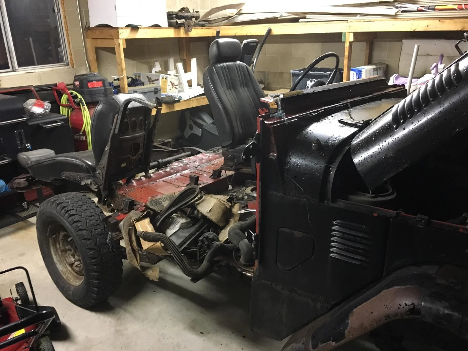

Hey everyone, resurrecting an old thread here as I just moved the FJ40 into my garage/home shop. Wanted to post some photos and get some feedback from you. I am not so sure of the date of my cruiser as it was built in November of 1977 and could be a 78 model year. I feel like this is important information to know. I have included some photos for everyone to help me.
I think by the time you either reconstructed the tub yourself or bought the component parts to reconstruct the tub yourself, you could just buy a tub. And you'd fast forward the process by about a year.
I'm not denying that! I'm going to star the tear down procedure this weekend to see what I am working with under the destroyed remnants of the tub. I will begin the process of looking for a tub once I figure out which year FJ I have as well as once I determine the condition of everything that is still hidden. I hope to have everything torn down to individual sheet metal and have just a frame and drive line sitting there but the end of Sunday.
It would be a 1978 model as the break is usually the preceding September.
There is data plate info in the FAQ and this page: Serial number questions
Thanks for the help man! I plan to photo document the tear down on sunday and will post the photos up here and in my media file for all interested parties.
78 is a good year. 4.11 gears and fine spline pinion. You can pull the pinion flange to verify.

Referring to the photo above, the round hole next to your glovebox - should be a matching hole at the other end of the dash. These were where defrost vents attached. '78 was first year for them.

tear down?
you mean lift the cowl off the frame and throw it away?
I am not sure if its going to be thrown away or if I will repair it. Still pretty up in the air on it.
Thanks for the heads up, I am going to need to find alot of photos of a complete 1978 so that I may figure out what I have and what is still missing and what may be laying in one of the boxes of pieces that I have.
