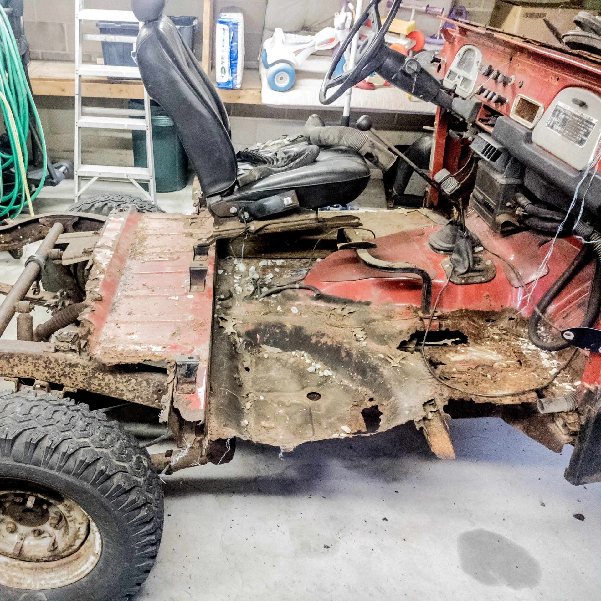

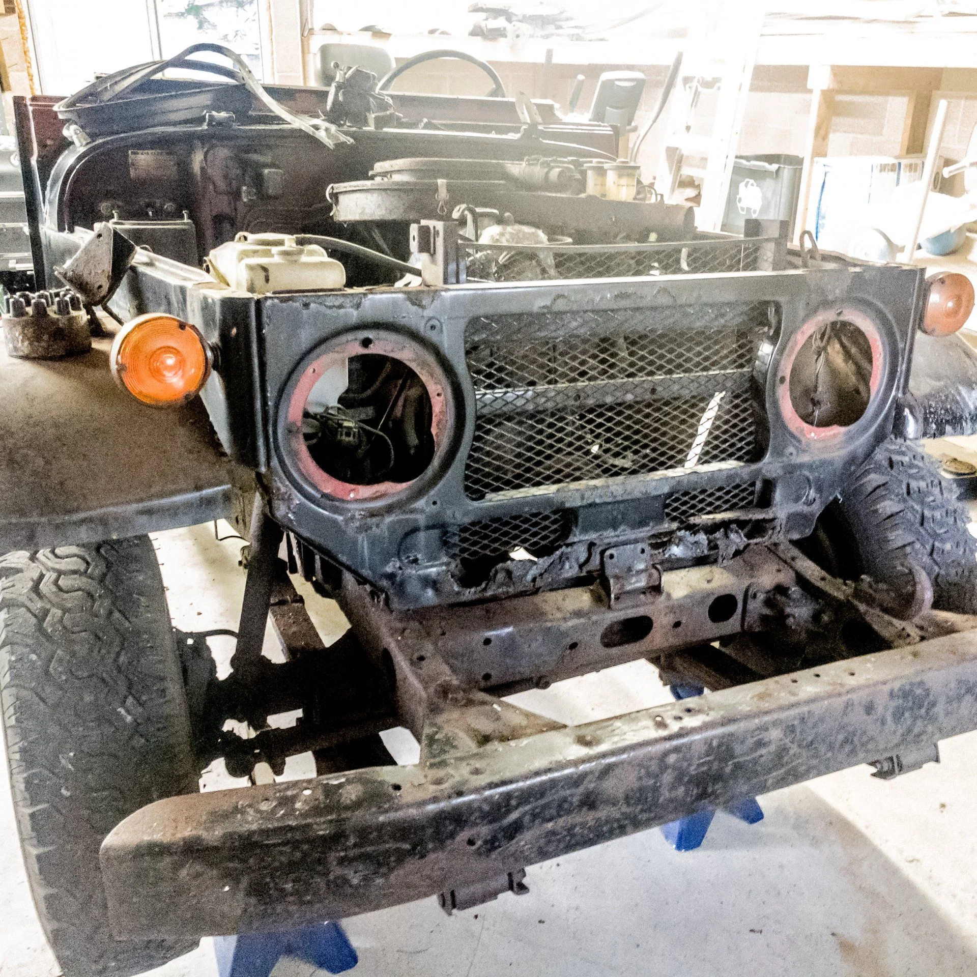

Since your 40 is so far gone, I would consider converting it to a fj43. You would get more interior room, longer wheel base, it would be very unique as they never sent fj43's to the USA. You could have aqualu get you a fj43 body out of aluminum and a fj43 frame which they make as well, or extend your current frame depending on how much labor you want to do yourself. Making a fj43 would only cost a few thousand more over making a 40 from the point your are currently at now. You could get a fj43 soft top made in the US custom or get one imported by landcruiser heaven in columbia. Coilover is a ton of work, I would consider a simpler spring over axle setup. It will ride pretty nice, look good, and will do great off road if you are careful to not make it too tall. Try to keep frame height less than 23 inches. If you are going hardcore, I would also consider wider axles. Something in the 63" to 65" wms(wheel mounting surface) to wms width would still look good but greatly improve stability. You could do this with toyota axles or american axles.
