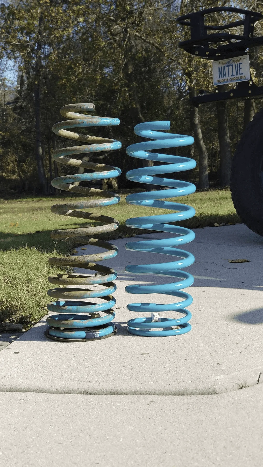

When I had Dobinson Flexicoils on my Cruiser, the rear springs and shocks did not handle heavy loads very well. I considered purchasing these to improve the weight handling.
I ended up going a different route and replaced my Fox shocks and Dobinson springs in the rear with Dobinson IMS shocks and Dobinson tapered coil springs instead. We haven't done any camping trips to test the new suspension yet.
Yeah that's exactly what I've been looking at. I like how my truck rides now so was trying to avoid heavier springs and just use the airbags when towing or if I'm really heavily loaded. Might be worth trying some tapered springs though.
Dobinson Flexicoils are a progressive spring but with a family of four, two dogs, camping gear, fridge, rear bumper, spare tire, the spring rate wasn't enough and the Cruiser sagged quite a bit. The Dobinson tapered coils are a much more progressive spring with a soft initial feel with a rapid ramp up for heavier loads. They should maintain a soft feel and control even with more weight. My Flexicoils were 4", the tapered coils are 3" but on the truck the height is about the same.
The airbags are nice for providing support when needed and not impacting the ride when they are empty.
