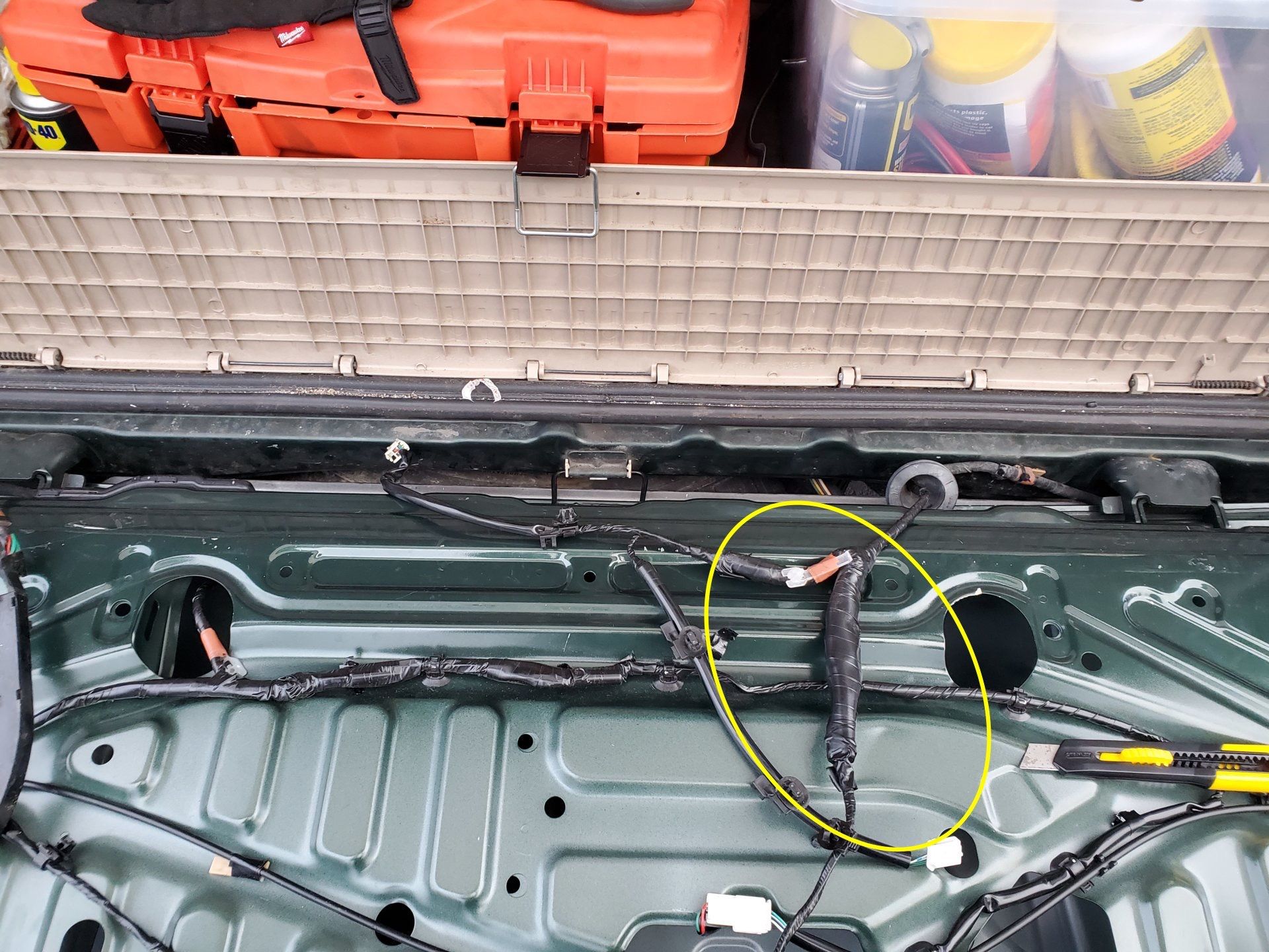

Hello Mud members, I am in need of some help with lower tail gate wiring. I got lucky and found upper and lower rust free tail gate on ebay that matched my color. I also got them for a good price, both for 950 including shipping. I was so happy to see the finish product and then be able to drive it tonight as well but I hit a snag.
The lower tail gate might be for a newer model LX because my 99 LX tail gate wires were going into the gate on the passenger side and this new one has the wires coming out of driver side. Mine has a huge rubber grommet and the replacement one is like a plastic. My only option at this point would be to splice the wires. My question is does any body know what wires I should be connecting to each other and any other suggestion will be welcome as well.
I am attaching some before and after pictures and for the wires as well.

If you look closely the gate wires are coming out on the Driver side and on the passenger side you can see the rubber grommet, old wiring.
1926877
6 wires coming out of the new tail gate, 3 green 1 white, 1 red, and a white with a blue line.
1926879
Wires from coming out of the bumper are 3 green, 1 blue, 1 white, and 1 red.
I have never done any electrical work on any of my cars, so I am not sure if it as easy as it looks.

I cannot due to the fact the new one comes out the DS and is not long enough to reach the original wire harness. On the passenger side there is not hole for the wires to go in. I am worried about the cutting, one wrong wire and I might short something out.

two bulbs in the lights. The connecter seems to look the same for the old and new one.
I hope this will help...info from the Toyota LX EWD manual, 2000 version. It's identical to what's in our 2001.
With that said...
Back-Up Light Red with black stripe
Stop Light Green with white stripe
Tail Light /License Lamps Green
Turn Signal Light , DS Green with black stripe
Turn Signal Light, PS Green with yellow stripe
@Jason YY Keep in mind you'll see continuity through a light bulb (the filament is just a thin wire), so all those wires will look like ground until you remove the bulbs.
Go with the wire colors as gospel.
Thanks again for the white / black stripe as ground.
