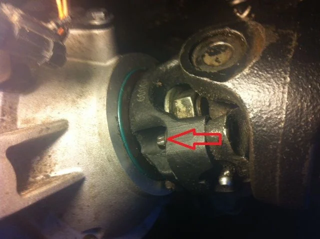

Hey guys,
I was attempting to pull my rear drive shaft out from my t-case when the last bolt head stripped on me. It is a tight space any idea on how to get this sucker out. Not sure what tool to use. To tight of a space for anything, but a wrench really.
it does look tight. Not enough space for one of those bolt-outs affairs, possibly shortened?
But if it comes to that, wouldn't grinding the head off allow you to just pull the thing off?
I'd knock it off with a cold chisel if possible then remove what's left after the driveshaft is off
