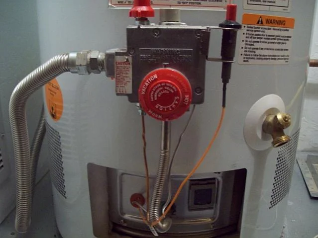

Every once in a while the pilot goes out. When I try to refire it the burner will flame up like normal then slowly die out. Sometimes I can get it going and it will be fine for a month or so. Acts like it's starving for fuel or air, (but not all the time) any ideas?
I think this generally indicates a problem with the "thermocouple". It is a temperature sensing device that will shut the gas off if it thinks the pilot light as gone out. The tip of the thermocouple is within the pilot flame, and after time it can burn out. On your unit, I'm pretty sure it is the copper line that comes out the bottom of the temperature regulator. You should be able to get a replacement thermocouple at a hardware store, for $10 or so.
Thanks, I'll give that a try, it's also alot cheeper than the control.

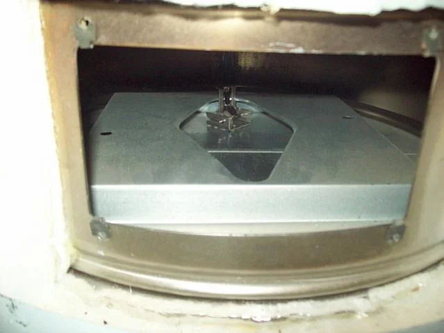

Fresh air intake...
Clogged up with fiberglass lint. The leaf blower works great at filling the immediate area with a cloud of fiberglass dust (wish I would have seen that one coming:o).Stuffed the nozzle in the hole in the pic.
Works great now and it's got a new thermocouple.
