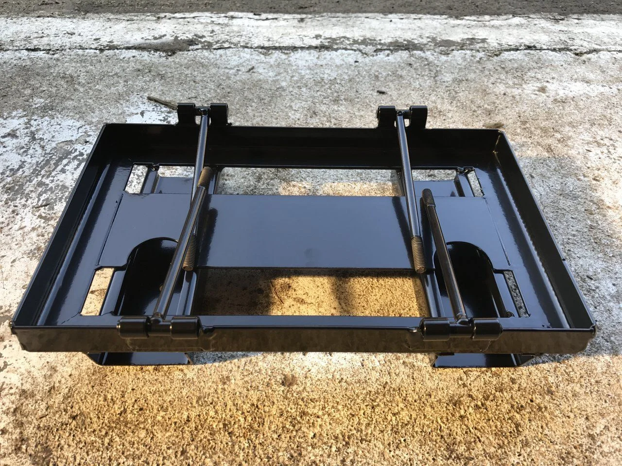

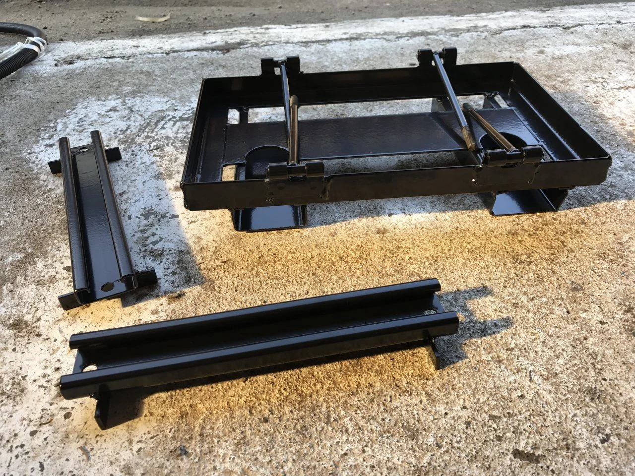

Yes I do need to figure that out. I have replaced the batteries with 2 pc1200's stuffed into a single homemade tray freeing up the right side engine compartment for a small compressor.
I have the Espar unit set to automatically shut off if the batteries reach 20v but this was too low on my old batteries.
The new units have a 10h amp rating of 40a each. The odyssey batteries are supposedly good in both starting as well as capable of being repeated drained like a deep cell but hopefully they will not be drained often if ever.
