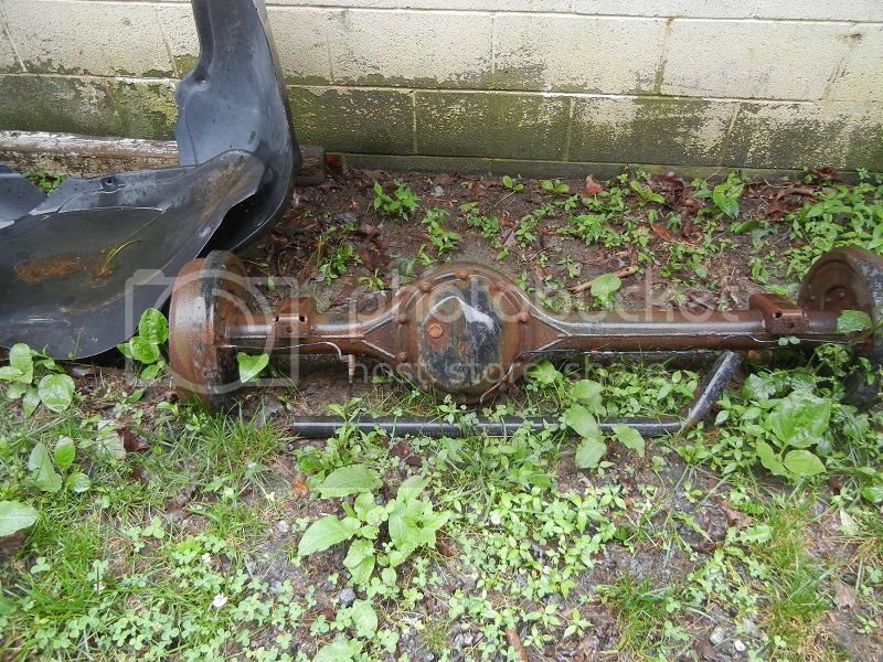

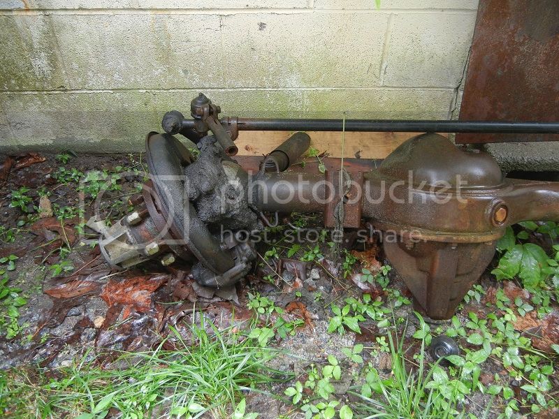

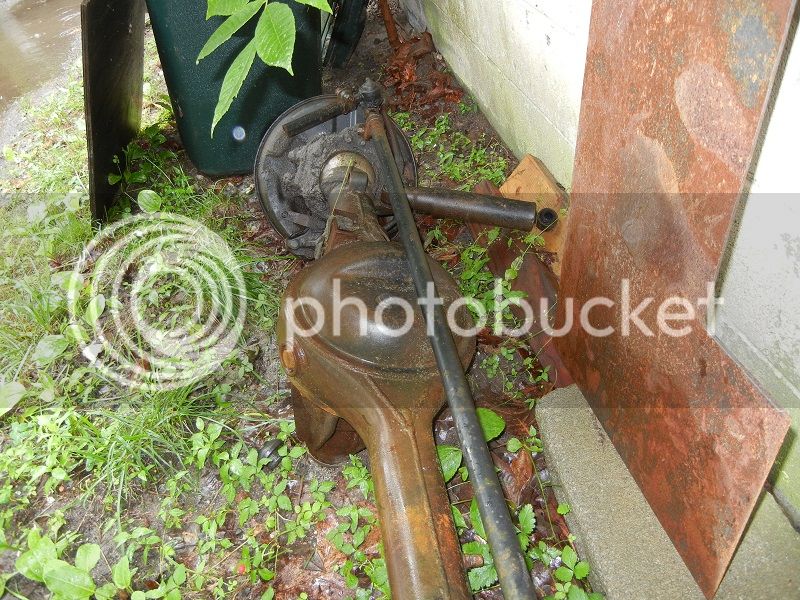

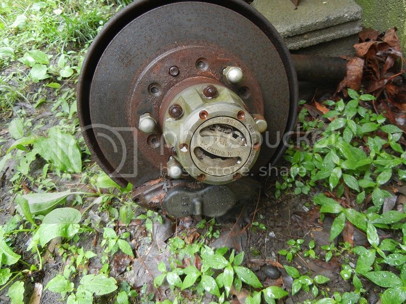

Any input on these and if they're worth anything would be wonderful. They supposedly came out of a 74, but I didn't think 74s had discs up front. Are these worth selling whole or parting out?
Just from my phone looking here. But they do have the small diameter bolt size for the knuckles. Could of been swapped earlier in life. Disk brakes were not till 9/75 FJ40's. In this day and time you never know what people have done to axles .
Pretty sure those are small pattern knuckle - with what Darin pointed out, that would put them 9/75-12/78 IIRC.
