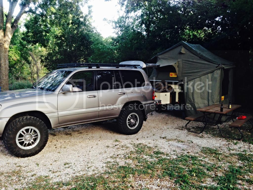

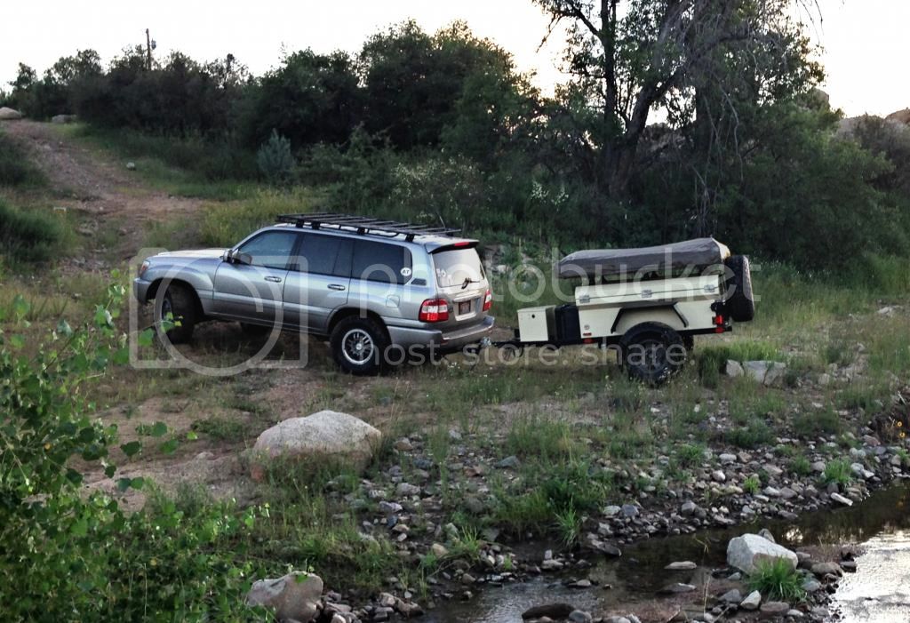

Hello, Thats me ! At the time of HIH I was running Slee AHC override with Toyota Tundra Rock Warrior Wheels in 17" with 295/70/R17. I had some issues with it droping from High back down to Neutral. Loaded with camping gear extra weight or over compression seem to do it. Last week pulled all of the AHC and installed OME 2.5 with Heavy springs & Slee Diff drop. The front is not as high now and I have some rubbing in the front. Also with the heavy's in the rear and no bumpers or drawers the rear is riding high 1 1/2 from the front. I may crank up the T-bars but the angle would be twice what Slee recommends? Installing MetalTech rockslidders next week maybe the extra 200lbs will help a little? It does sit much better with my Adventure Trailer hitched up.
On the way home from Houston with AHC Slee Override
Post AHC removal with OME 2.5 Heavy springs, Slee diff drop
