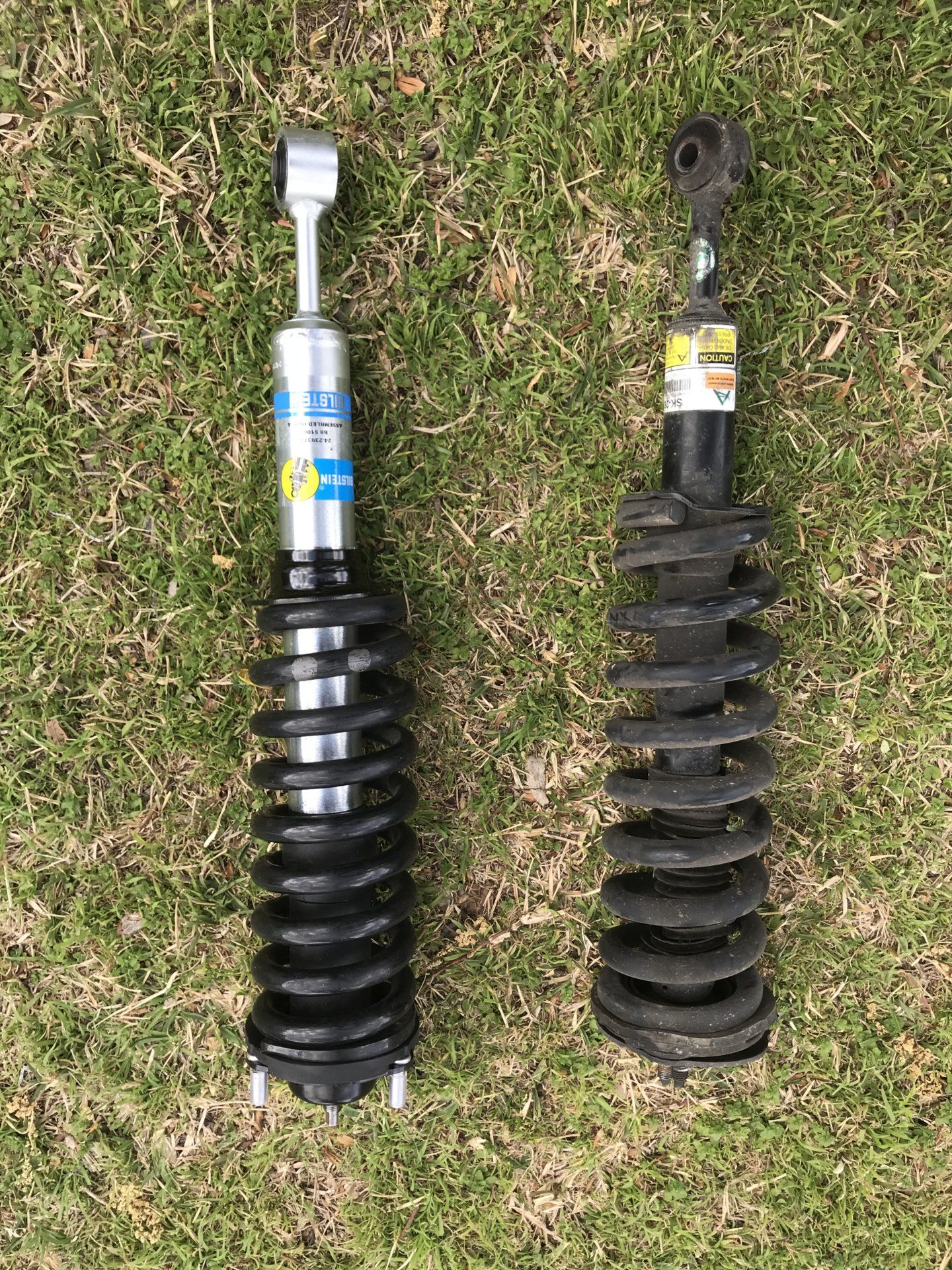

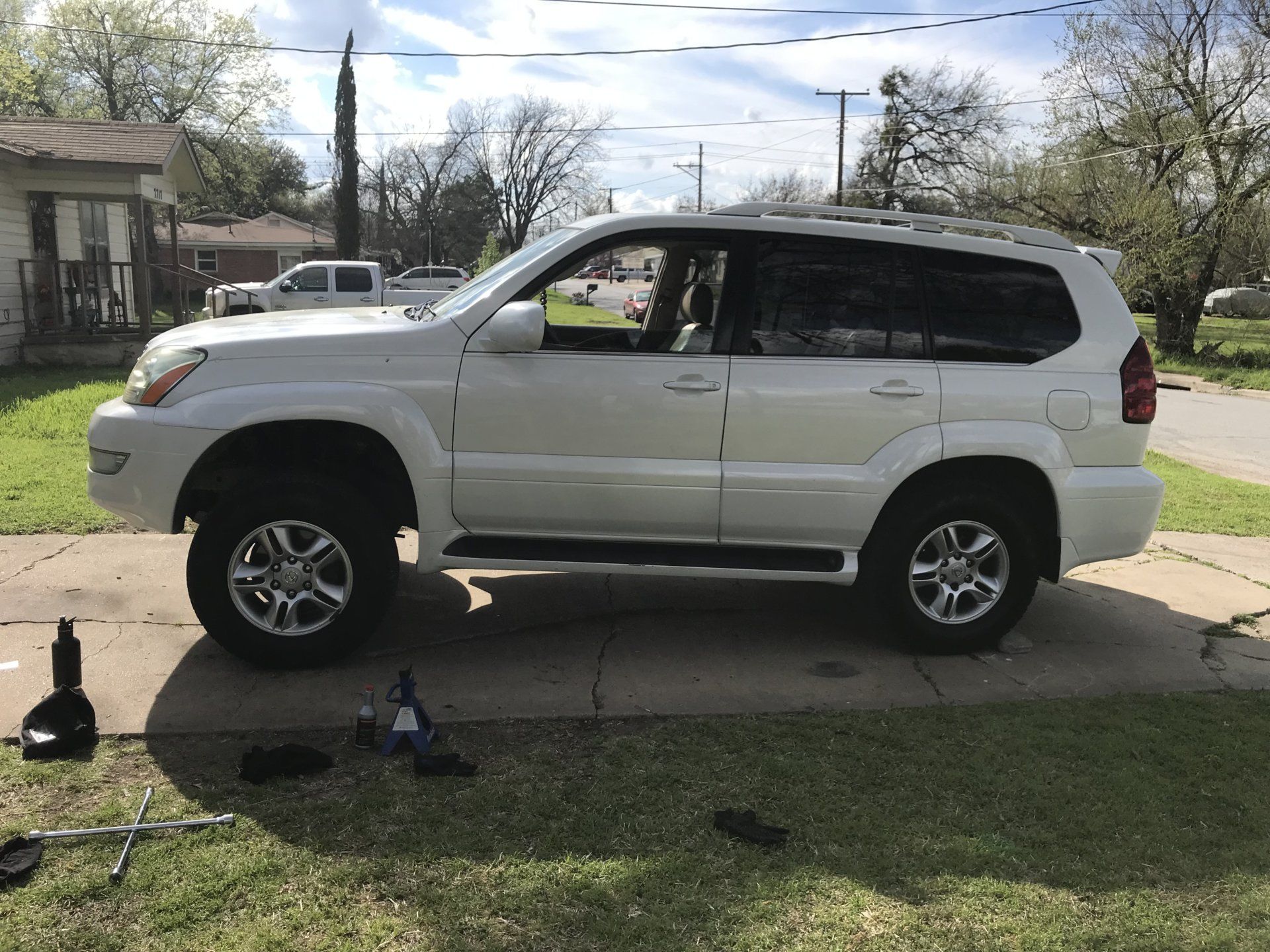

What’s up fellas. I’m pretty new and enjoying my Gx so far. I do have an issue I could use some expert help in. I installed my 5100’s today and the rear went great however the fronts are much taller than than stock. Any help would be great as I’m lost. I’m thinking a different spring maybe but I could be dead wrong.

LOL. Caught ya, though. I see it now.
I don’t see it. What was wrong?
Oh that will do it
How was the ride compared to stock?
Well looks like I have to look into some longer springs. After the shocks settled in, the rear springs just can’t seem to handle the load or maybe stronger shocks. Anyone run into this issue yet?

Springs handle the load, therefore setting the ride height. The shocks simply slow the rate of movement (damping). If you aren't happy with the load handling or height, choose different springs. My recommendation is to figure out what your ultimate load will be (gear, towing, etc.), then choose the spring accordingly.
Look at OME’s 2895 and 2895E springs. The E are basically the same as the regular but shorter. Nearly identical load handling but 15mm shorter OAL when unsprung. This makes them slightly “stiffer” as well but similar load rating but .5-.75” shorter lifted height (depends on which vendor you purchase as well as normal load).
If it’s load handling you desire look at stiffer springs. If it’s bouncing all over then look at some beefier shocks. If the ride is “too rough” then look for some softer shocks.
Call some of these vendors with your thoughts and complaints of current setup. Many of these companies drive what they sell and if the one on the phone doesn’t I bet he can grab someone in minutes that does.
