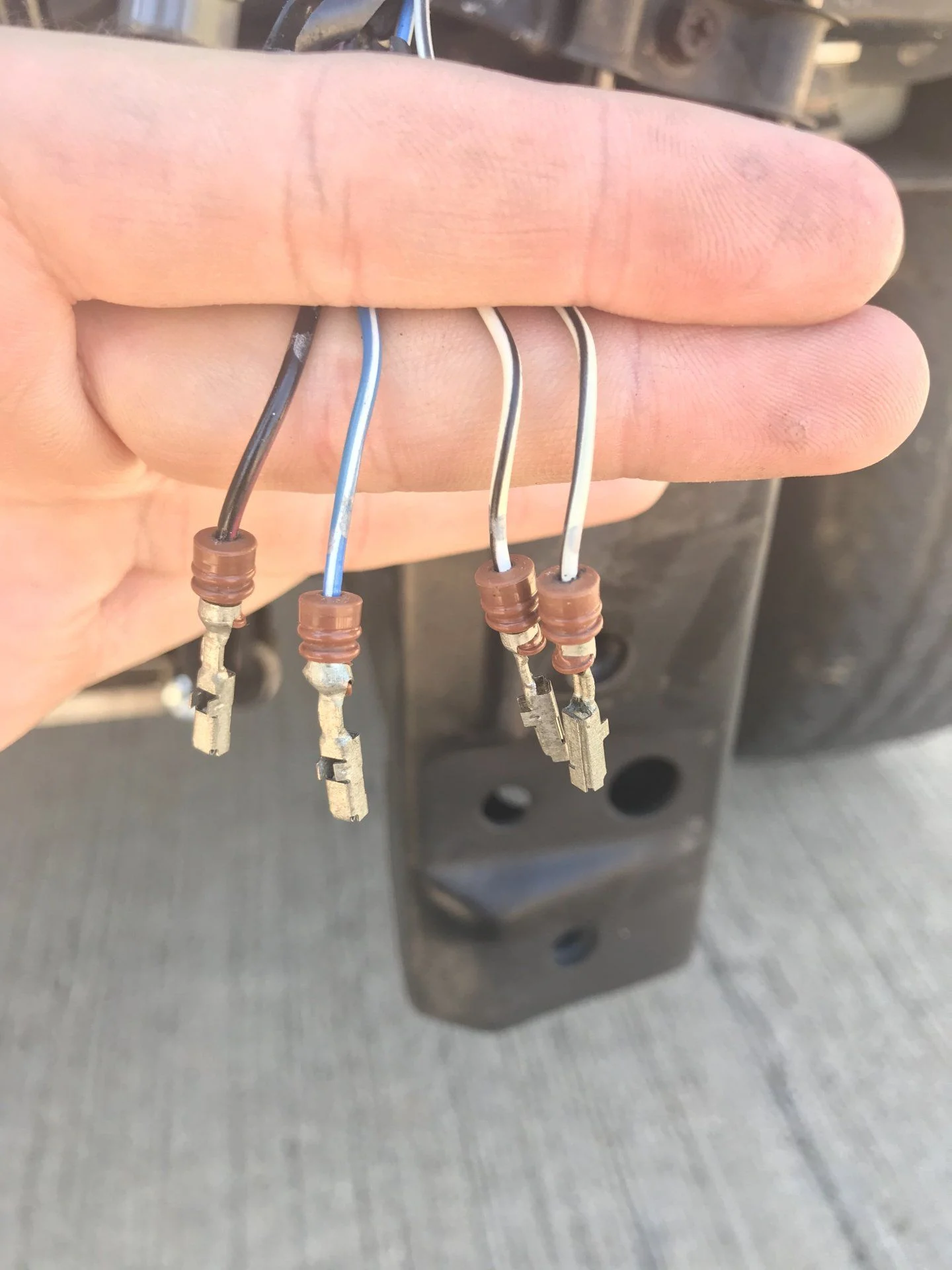

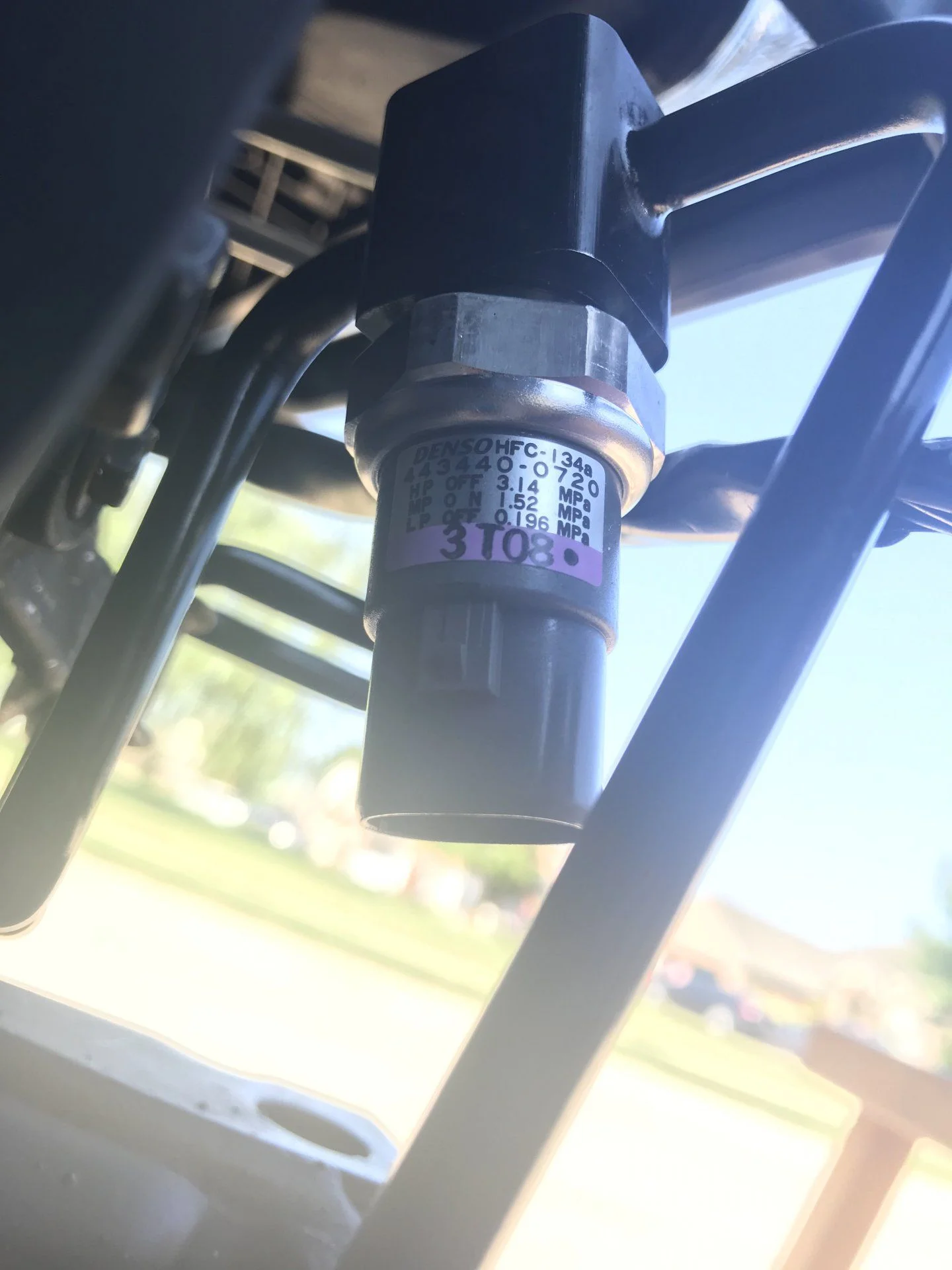

Now here is what I believe may be the culprit, the old high pressure switch had gotten damaged at some point when vehicle had been in an accident and all I had were the 4 wires which hook into the prongs the high pressure switch, but I do not have a factory "clip" on the end of those wires...thus I can only guess as to what wire should go where! I got a new switch straight from Toyota which is now installed, I just cant seem to guess the right wire order. I also cannot find a wiring diagram!
I've also heard that if theres not enough "freon" or pressure in the system, the AC compressor will not engage, I'm assuming my issue is a combination of both this and the pressure switch wiring.
If anyone knows of a wire connector for these 100 series I could wire in, a wiring diagram, or any other LC AC advice it would be greatly appreciated. Just trying to get this vehicle road worthy again!
New High Pressure switch installed, the sight glass is on top of this.

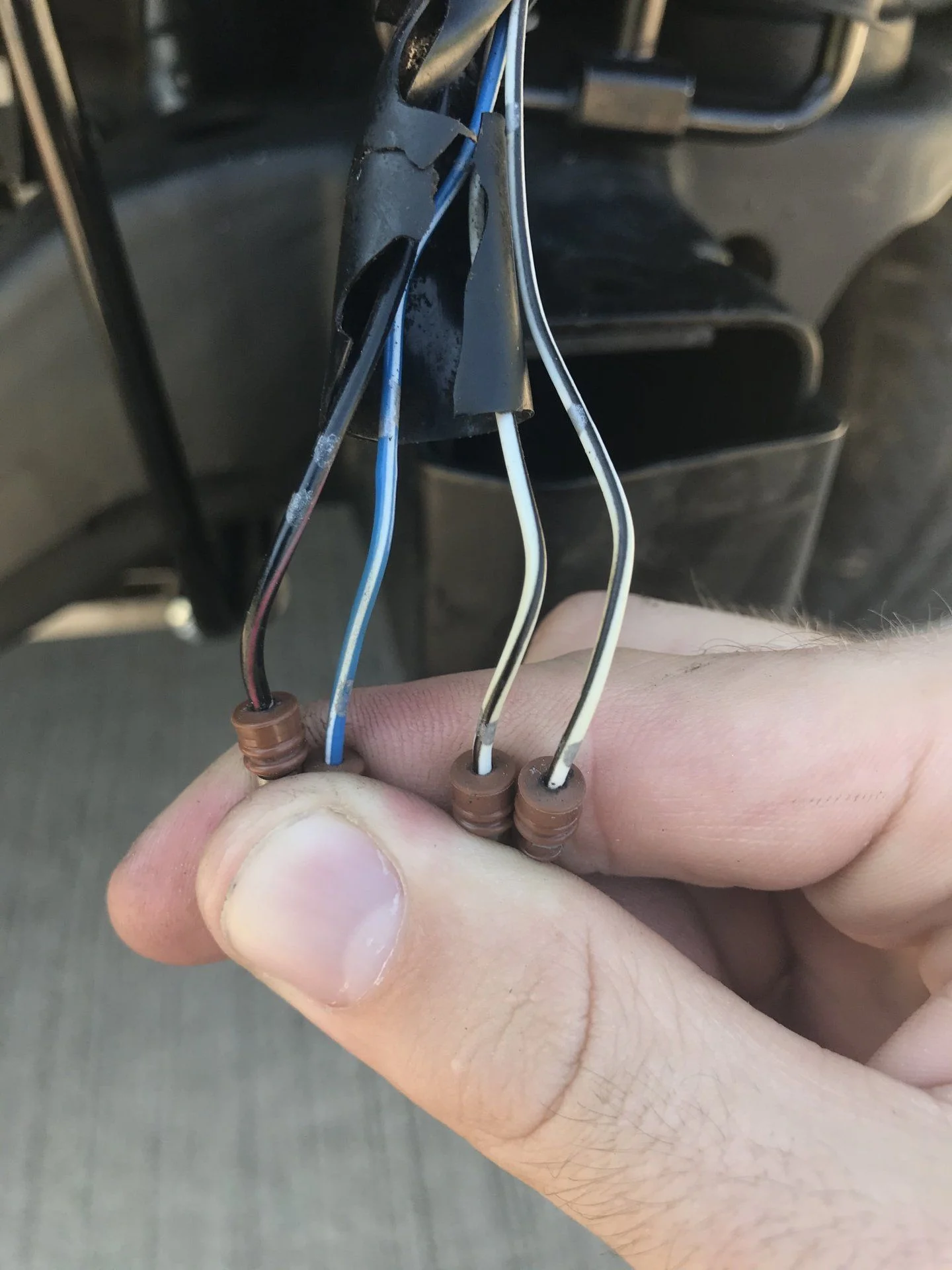

Wires look to be red/black, blue/white, and two black/white.

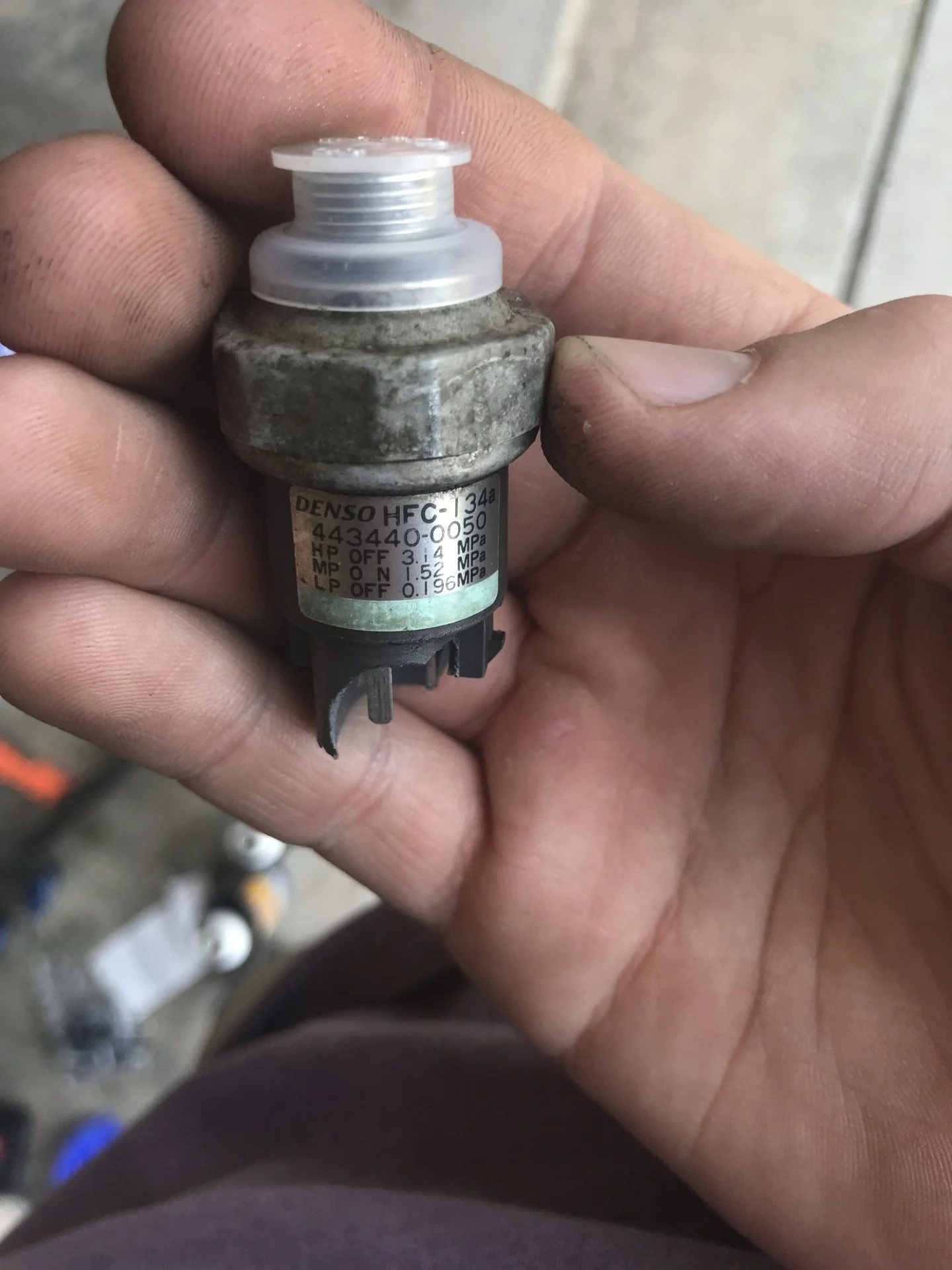

Old original high pressure switch which used to be on vehicle (no lines were not connected to it originally)

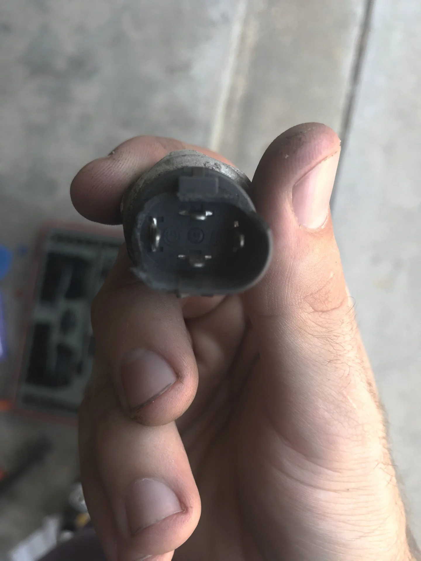

These high pressure switches have 4 prongs inside which correspond to the 4 wires.
Procedure for testing the switch and wiring diagram attached. Switch wiring and wire colors are on page 4 of the wiring diagram. From the Toyota connector manual the connector housing part number seems to be 90980–10943.

Thank you so much for those diagrams, they definitely helped! Hopefully I can have it back in order in no time!
Well I got the wiring right but AC Compressor would not kick on. Ended up biting the bullet and taking it to my local dealership.
Diagnosis was a bad expansion valve and evaporator so $1400 later and a good recharge and she blows cold AC again. Glad we found the issue.
Hi, can you let me know where those 4 wires in the picture go? I am fixing my crashed 2000 LC and that harness got ripped out.
