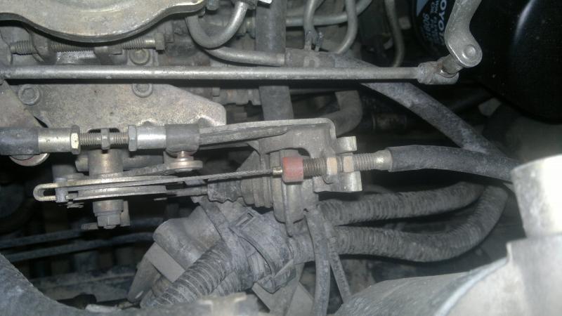

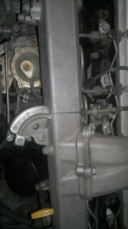

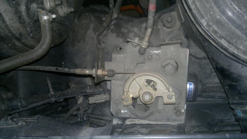

Hey Cancruiser,
Some pics.
The first one is outside the firewall on the driver's side. The black cover is removed, this is the first adjustment point on top of the cruise control, then the cable crosses over the motor to the right of the turbo (pic #2) and goes down to the kickdown (pic #3).
Any help is appreciated!
Here you go.. All 3 pictures..
The only cable I had to adjust when I had the hard shifting was the one in pic #3 (the kickdown cable). As you can see, I have the ferrule on the cable almost touching the red stop. I found it shifts better this way. Not the best, but much better.
Which one of these cables did you play with and caused your problems?
Hope this helps..
Other than reducing the slack in the throttle cables, the kick down cable is the only one that will affect shift points on the hydraulic A442F. The kickdown cable is the one with the orange boot and the small bead.
Adjust the cable so that the bead is about 1 - 2 mm from the stop (orange boot).
Tighter = later harder shifts
Looser = early soft shifts
Early soft shifts are hard on the clutches in the trans, as there is too much flaring and clutch rubbing.
Firm shifts are what you want.
The adjustment can be quite sensitive to slight changes.
Make sure your trans fluid is in good shape, not burned smelling or discoloured.
~John

I adjusted mine like your third Pic cancruiser and now it shifts like butter.....amazing, thank you. Now id i could only figure out why my cruise wont do anything!
