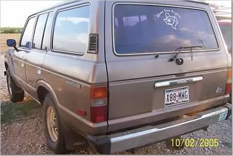

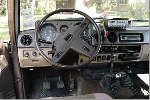

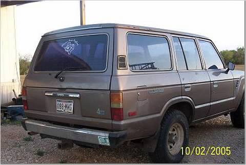

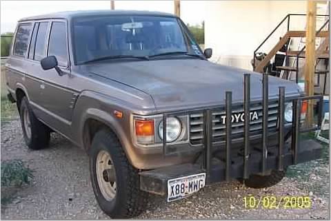

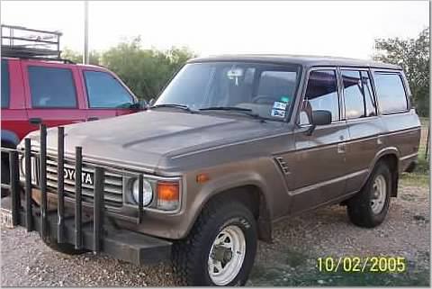

Here's the ad on the landcruiser: $2500
1985 Toyota Lancruiser
For sale 1985 Toyota LandCruiser with custom built front bumper and built in rod rack. Straight 6cyl 4 speed manual, brand new 31'tires and wheels, 2 spare tires, front differential seals replaced no leaks, new clutch slave and master cylinder, new add a leafs in the rear. Rebuilt carb 6 months ago, new battery, new windshield, new shocks. Has been to Pins a couple of times and is geared really well for the sand. I have all the original service records since it was brand new. Engine was rebuilt by Toyota with less than 100k on it and it has about 170k on it now. Has a/c but compressor clutch is out. Has some rust but nothing major in the normal spots. Starts and runs strong will go anywhere.
here's a few pics of the land-cruiser (it has been used as a fishing/hunting vehicle before, hence the weird front bumper with fishing rod holders.).
