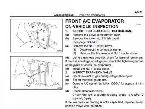

image.webp My LC service manual shows eight screws.
BTW, that's the evap coil cover.
Thank you both for the replies. It must be mess with the new guy day or something. Someone previously put some kind of velcro strip directly over one of the screw heads so I couldn't tell there was a screw there.
