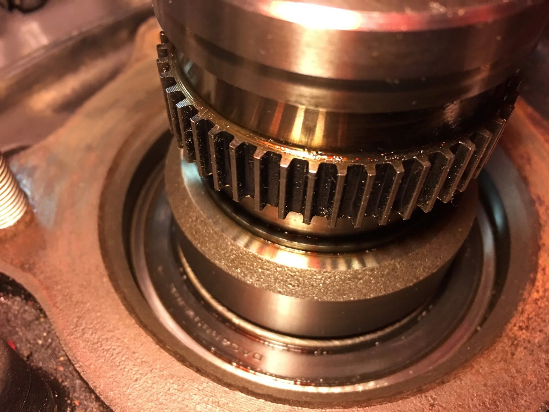

After further inspection, I'm starting to second guess whether the bearing requires replacement. Of course I could be biased to either the cost of the dealer removing/installing or the effort required to take care of it myself. There is currently zero play in the existing bearing (at least to my eye). I've attached a couple pics of the bearing but I need to remove the hub tonight to inspect the outer oil seal. Any thoughts on more thoroughly inspecting seals to determine if just replacing the seals is adequate?
Thanks for your help!
The rear axle bearings are sealed, so you can't repack them like the fronts (as far as I know anyway). If there seems to be no play, you're probably good. Check the oil seal for scoring or cracks or oily dirt caked on there. If they look good, they probably are.
